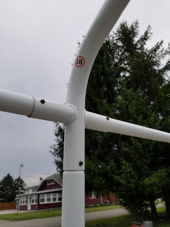

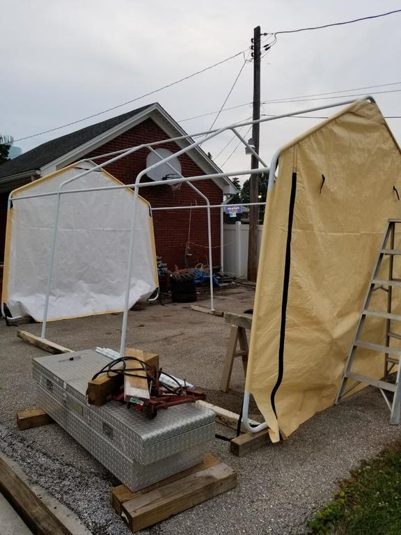

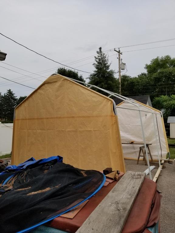

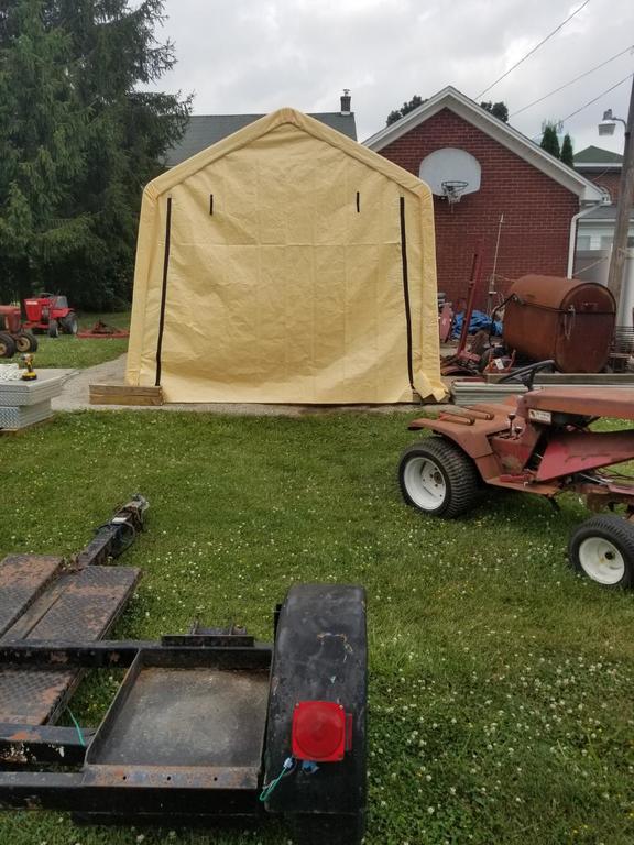

cafoose 3,487 #1 Posted July 6, 2019 I went to harbor freight and bought one of their portable sheds for some of my horses. I got the extended warranty so if anything happens to it in three years I get a new one! It tells you just to slip the pipes together but I put a duct work screw in each pipe and also screwed it to a heavy 4 x 4 frame to hold it down. 8 Share this post Link to post Share on other sites

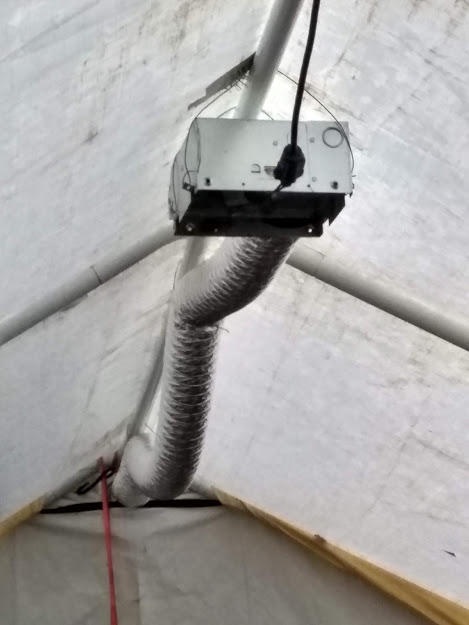

rmaynard 16,572 #12 Posted July 6, 2019 (edited) There are small openings in the gables, however on mine I added a little assistance. This is a cheap bathroom fan that is vented out the rear gable. Even though I have the ground covered with plastic, the humidity level gets so high that it "rains" even with the fan going 24/7. Most things that are not in sealed containers have been water damaged. I live within 20 miles of Cafoose, so the weather conditions are the same. As far as snow load, we have had some major snows within the last 3 years, and I have had no problems. Edited July 6, 2019 by rmaynard 1 1 Share this post Link to post Share on other sites
cafoose 3,487 #13 Posted July 6, 2019 (edited) 33 minutes ago, rmaynard said: There are small openings in the gables, however on mine I added a little assistance. This is a cheap bathroom fan that is vented out the rear gable. Even though I have the ground covered with plastic, the humidity level gets so high that it "rains" even with the fan going 24/7. Most things that are not in sealed containers have been water damaged. I live within 20 miles of Cafoose, so the weather conditions are the same. As far as snow load, we have had some major snows within the last 3 years, and I have had no problems. Good idea I may just do that. Hopefully being on asphalt I won't have a lot of condensation I think when it's nice out I will leave the door up. Maybe a bigger fan than yours would be better? https://www.lowes.com/pd/Air-Vent-18-in-Dia-Electric-Gable-Vent-Fan/3143421 Maybe these on either end? https://www.lowes.com/pd/Master-Flow-20-75-in-x-26-75-in-White-Rectangle-Plastic-Gable-Vent/1000069555 Edited July 6, 2019 by cafoose Share this post Link to post Share on other sites

rmaynard 16,572 #15 Posted July 7, 2019 There isn't enough room for a big fan. That is why I used 4" inch flexible duct. Share this post Link to post Share on other sites
ebinmaine 74,517 #16 Posted July 7, 2019 2 minutes ago, rmaynard said: There isn't enough room for a big fan. That is why I used 4" inch flexible duct. What did you put in for the Gable end? Share this post Link to post Share on other sites
