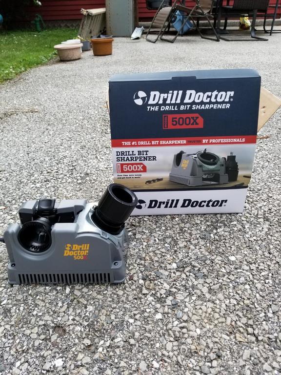

cafoose 3,817 #1 Posted July 6, 2019 I just got a Drill Doctor from amazon and I really love it! I did a 1/8 bit in a few seconds and it made it like new! https://www.amazon.com/Drill-Doctor-Professional-Construction-Industrial-Strength/dp/B000BKUY1O/ref=sr_1_5?keywords=drill+doctor&link_code=qs&qid=1562376067&s=gateway&sourceid=Mozilla-search&sr=8-5 3 1 Share this post Link to post Share on other sites
wallfish 20,515 #2 Posted July 6, 2019 They work great for those bits smaller than 1/2" Go through your pile of dull bits and enjoy. 1 1 Share this post Link to post Share on other sites
squonk 47,898 #3 Posted July 6, 2019 I had an old engineer as a customer. We were discussing sharpening bits one day and he said "while a drill doctor will sharpen a bit, it won't fully sharpen one". Then he starts explaining all the angles involved ect.. I gave him my drill index and a week later in he comes with all the bits sharpened. WOW! They worked better than a brand new bit right out of the package and stayed sharp a lot longer! 2 1 Share this post Link to post Share on other sites
