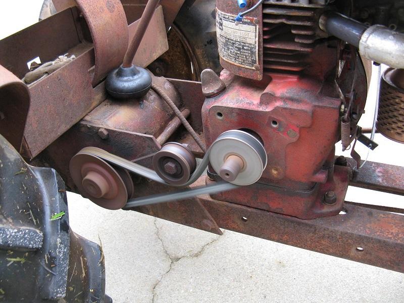

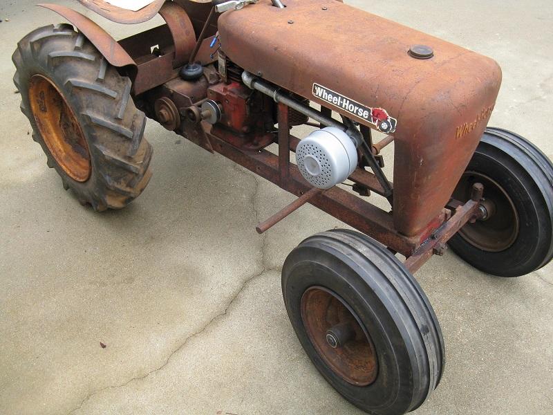

870express 116 #55 Posted August 3, 2019 I decided today was the day. I pulled on the start rope for a couple minutes - nothing. Got compression? - check Fuel tank petcock open? - check. Got fuel in the carb? - check Kill switch open/run? - check Got spark? - nope Disconnected the kill switch. Bingo! She fired right up. Some darkish/greyish smoke for a few minutes, then it cleared up. Idles a little fast. Advanced the throttle and it chokes down - probably a clogged air filter. I let it idle while holding some steel wool on the drive pulley to clean it up and make it shiny. Then very carefully put the drive belt in place, and the transmission began spinning in neutral and seemed to run peaceably with no ominous sounds. I let it run for about 10 minutes, then my excitement got the better of me. I hopped on, pushed the clutch pedal down, eased it into 1st gear, and let the pedal out slowly. It took off and I drove it around the yard for a few minutes. Since the steering link was broken, I had to kick the front wheels with my feet to turn right or left. It will pop a wheelie when starting in 3rd gear. It still needs a lot of tweaking, but it's a start. It's ALIVE, Igor! IT'S ALIVE! 4 6 Share this post Link to post Share on other sites

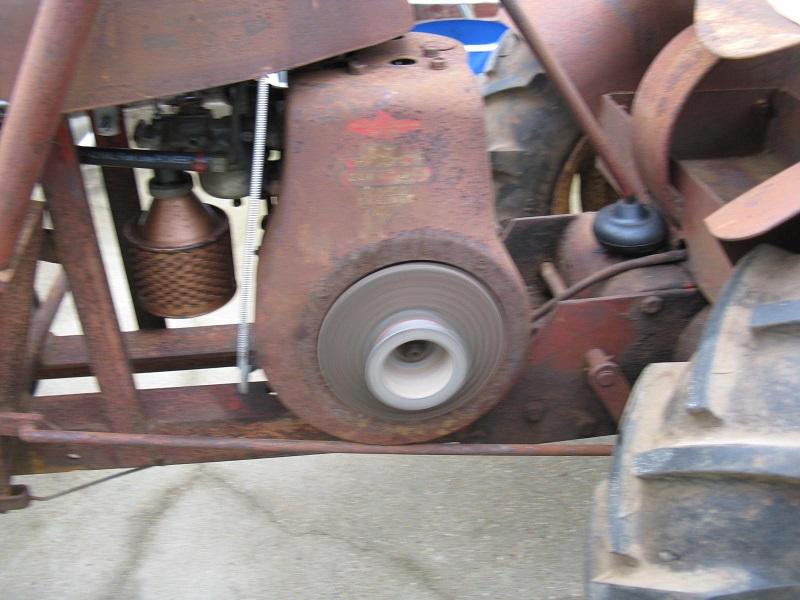

Horse Play 393 #61 Posted August 8, 2019 Anyone else notice both tractors have the lift cable routed under the engine between the frame rails? Was that originally how they were to be routed? Share this post Link to post Share on other sites
