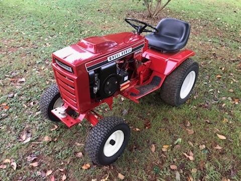

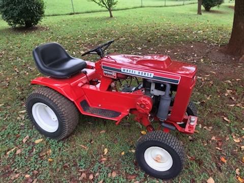

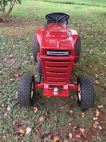

McGrew 461 #10 Posted August 25, 2019 Okay guys, it took longer than I planned (it seems that is the norm...) to get the decals on and get some pictures taken. But I got it done. I modified the hinge mounting points to make the hood fit correctly, and made new brass bushings for them. I applied the decals a couple weeks ago, and they went on without a problem, and look great! The rest of the paint on the tractor is some color my Brother put on it when he restored it over 20 years ago. One day, I will find the time to make it entirely Regal Red, but this tractor is a worker, and the two tone paint has not kept it from working! Here are the results: 1 5 Share this post Link to post Share on other sites

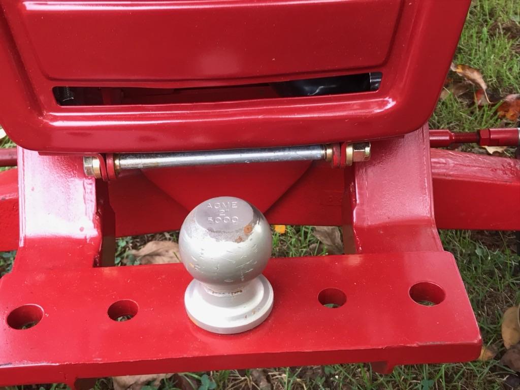

rjg854 12,590 #11 Posted August 25, 2019 I like what you did with the head light, looks as though it's always been like that. Can you give us a close-up picture of that? Share this post Link to post Share on other sites
McGrew 461 #12 Posted August 25, 2019 Rjg854, sure! I cannot figure out how to post a link to the thread on my IPad, but if you do a search on this site for “LED Headlight Upgrade” you will find a thread I started back in May of this year. It details the install. I have not had many chances to get it out at night, but the light it puts out is pretty incredible. Danny 1 Share this post Link to post Share on other sites
