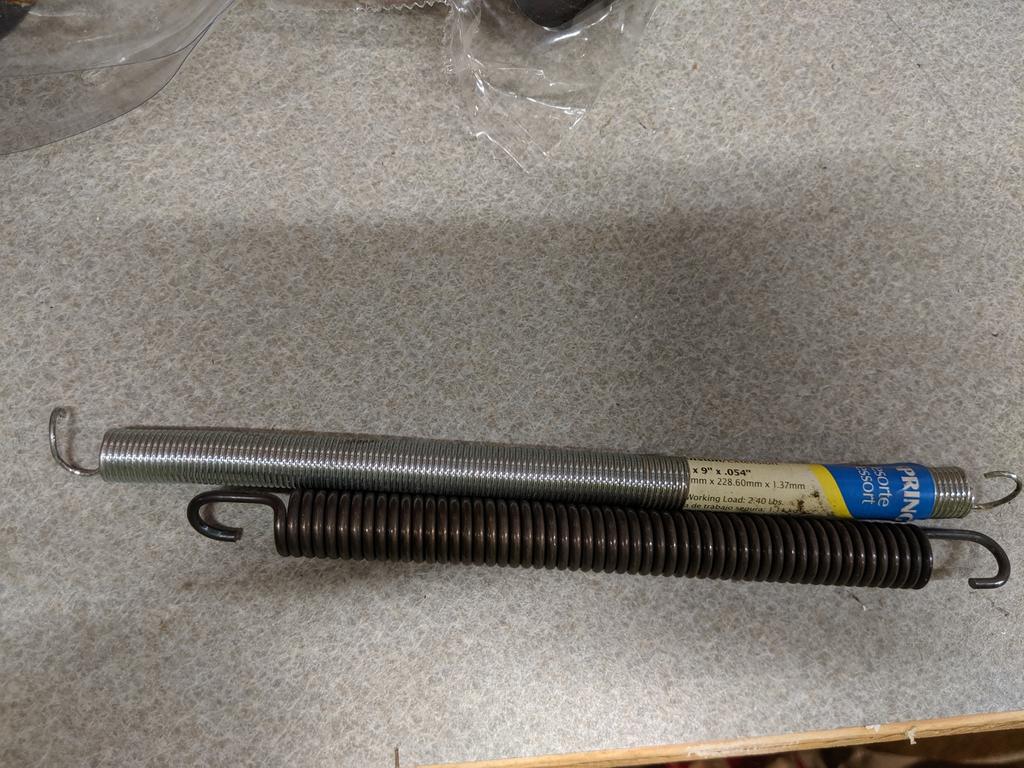

csvt99 173 #19 Posted July 11, 2019 Put the new spring on tonight. Seems to work great so far but I haven't been able to mow the entire yard yet. You can see the difference between the one that was on it, which does not look original. The Toro spring is much stiffer. Share this post Link to post Share on other sites
