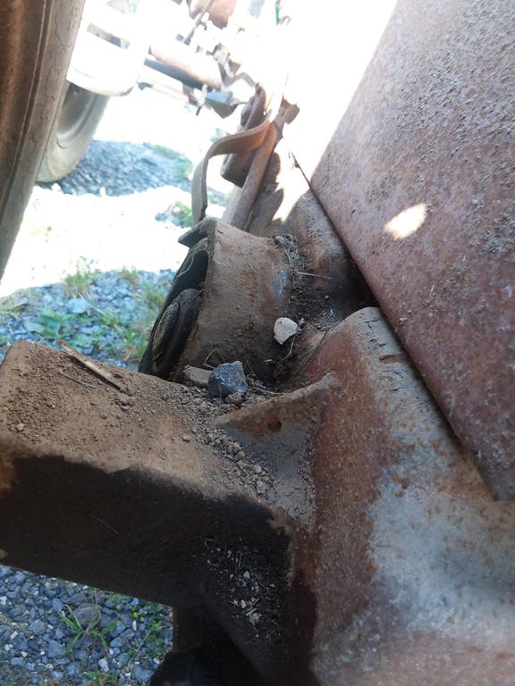

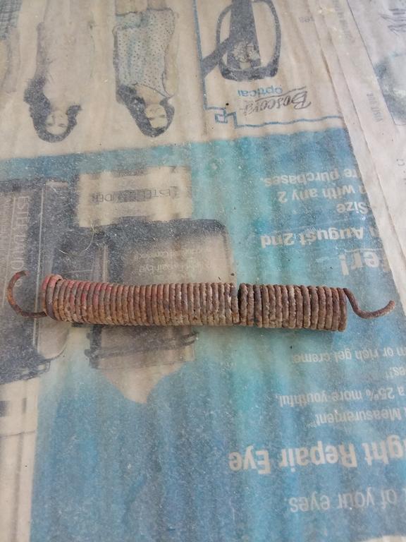

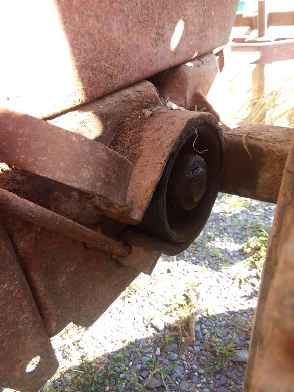

Jason Miller 24 #1 Posted June 28, 2019 I have this old Wheel Horse 856 garden tractor it was my grandfather's. I only use it for garden work like plowing and disking it has an 8 horsepower Kohler engine this morning the spring broke on the left pedal which somehow engage is a break or clutch mechanism can someone help me get a spring. 2 Share this post Link to post Share on other sites
ebinmaine 81,046 #2 Posted June 28, 2019 Welcome to redsquare Jason! I don't have the number of that spring off the top of my head like I do for the later models but somebody will be along shortly to help you out. That is the return spring for the clutch, and brake. Share this post Link to post Share on other sites

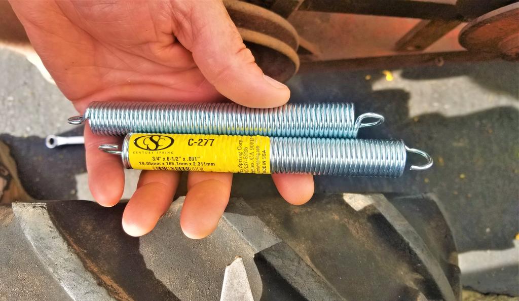

AMC RULES 37,260 #3 Posted June 28, 2019 Your local hardware store will have them... for proper sizing bring the old one with you. Share this post Link to post Share on other sites

8ntruck 9,367 #7 Posted June 28, 2019 For a quick fix, you could just bend the last remaining coil into a hook. However, your spring looks pretty crusty, so this quick fix would not be a permeant fix. Sooner than later you will need a new spring. Good luck. Share this post Link to post Share on other sites
Jason Miller 24 #8 Posted June 30, 2019 Got it thanks!!! Really appreciate the help! Share this post Link to post Share on other sites
