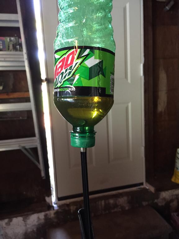

SylvanLakeWH 32,612 #5 Posted June 25, 2019 I just posted same question few days ago...motorcycle cable... I am trying this oil IV drip but no luck so far. Gonna try the the atf bath as well... 8 hours ago, AMC RULES said: Simply replace them. Unfortunately not an option...been searching for days and this 1982 CB 125S front brake cable is discontinued and no one has made one after market to replace it... 2 Share this post Link to post Share on other sites
