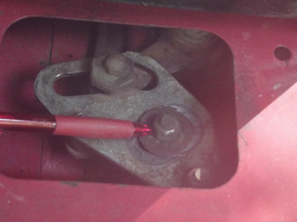

JAinVA 4,638 #3 Posted June 24, 2019 (edited) Creeping can be a matter of adjustment.Tilt the seat forward and with the tractor off move the motion control lever while looking down.You should see a nut with a large washer under it that resists motion.Tigten the nut until the lever does not creep anymore and do not use any lubricant on the washer or plate surfaces.Tip of the red pen is the nut you need to tighten. Edited June 24, 2019 by JAinVA 1 Share this post Link to post Share on other sites
Gary Ginsberg 0 #4 Posted June 24, 2019 1 hour ago, JAinVA said: Creeping can be a matter of adjustment.Tilt the seat forward and with the tractor off move the motion control lever while looking down.You should see a nut with a large washer under it that resists motion.Tigten the nut until the lever does not creep anymore and do not use any lubricant on the washer or plate surfaces.Tip of the red pen is the nut you need to tighten. Thank you. Transmission (rear end) near the transmission filter oil leak? Share this post Link to post Share on other sites
