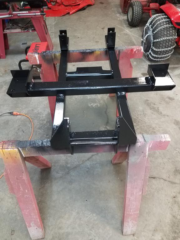

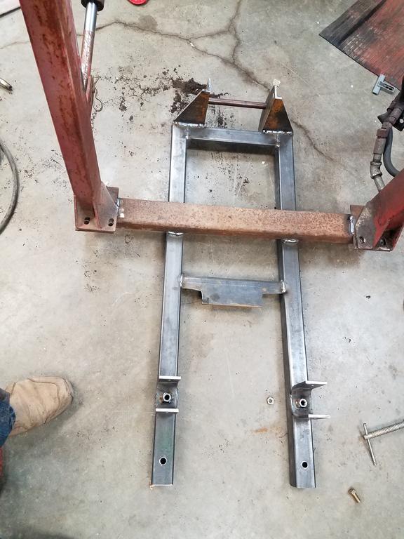

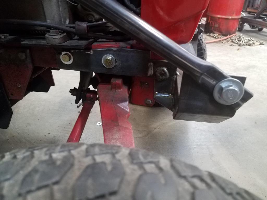

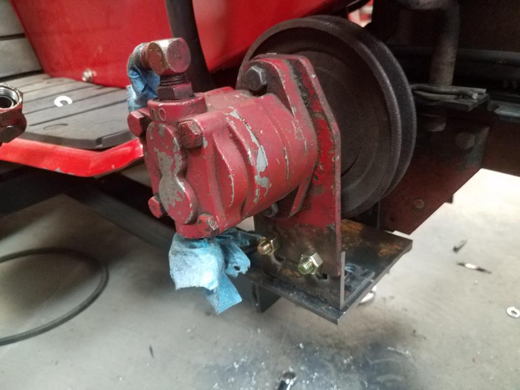

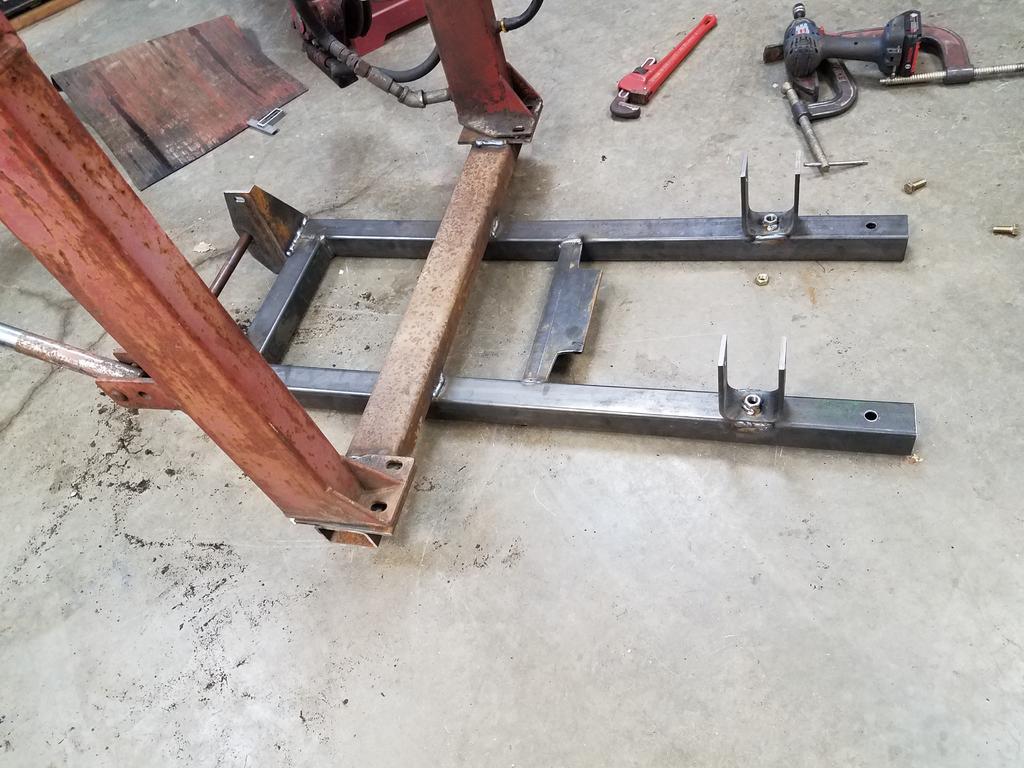

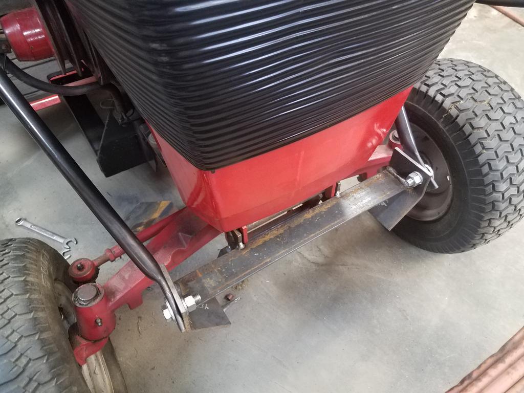

Shynon 7,604 #4 Posted June 23, 2019 Here's mine. A copy of a wheel horse branded loader i built for my 520 3 2 1 Share this post Link to post Share on other sites
