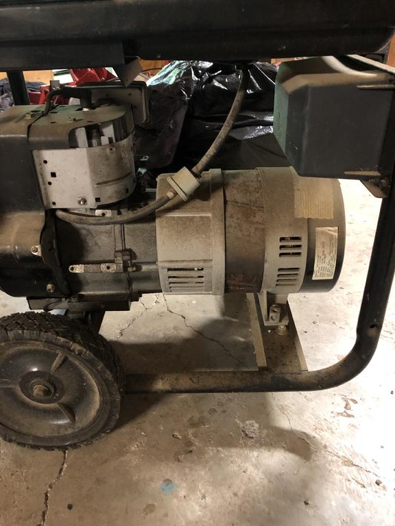

The Tuul Crib   7,340 #1 Posted June 23, 2019  Just last night we lost power here for 12 hours due to a storm that knocked a tree on the powerlines around the corner from my house. Luckily everything at my house was fine except for my refrigerators. Went to the shed pulled up my generator and would not start . So here’s what I’m thinking I have this generator that still is good so why not separate the motor from the generator and adapt it to one of my horses. Any thoughts ? 2 Share this post Link to post Share on other sites
Achto   29,794 #2 Posted June 23, 2019 1 hour ago, The Tool Crib said: Any thoughts ?  Only issue that I could fore see would be connecting it to the engine on your Horse. The engine & gen on a portable are connected by a taper connection. You may have issues fitting a pulley to on the generator shaft. Share this post Link to post Share on other sites
ztnoo   2,300 #3 Posted June 23, 2019 It probably would be easier getting the engine on the generator to run, IMO. You might want to try start it every couple of months or so to make sure it run dependably. Non-ethanol fuel might be the fuel of choice for a generator, for sure. The last thing you need are ethanol "pearls" gumming up the works to something that is really needed in an emergency situation. Just a thought....... 2 Share this post Link to post Share on other sites
JoeM Â Â 8,875 #4 Posted June 23, 2019 I have one like that and I believe the engine side of the generator used the engine as it's bearing for the rotor. The shaft was tapered on the engine. I too had the same issue and leaned toward repairing the engine. Carb issues with bad fuel. Works great. Share this post Link to post Share on other sites
19richie66   17,763 #5 Posted June 23, 2019 I saw a video of a guy who did this but took the piston and rod out of the engine(broke anyways) and put a pulley where the recoil was and ran it off another engine. No resistance from the piston/rod so it just turns. Would work in an emergency but I agree it would be less work to just get it going or buy a new one. But what fun would that be? 1 1 Share this post Link to post Share on other sites
The Tuul Crib   7,340 #6 Posted June 23, 2019 What is the old saying? invention is the product of necessity ? 1 1 Share this post Link to post Share on other sites
ebinmaine   74,516 #7 Posted June 23, 2019 I like the idea that Richie is offering quite a lot but I have to agree with the others that getting that one running probably would be the best course of action. Again. Not the fun part. Just the most practical.   Share this post Link to post Share on other sites

pfrederi   18,966 #14 Posted June 23, 2019 The bearings in the generator I would think to be the biggest issue if you try to mount some sort of pulley that is a lot of lateral force that generator shaft and bearings were not designed for. Share this post Link to post Share on other sites
ztnoo   2,300 #15 Posted June 23, 2019 4 hours ago, ebinmaine said: Just the most practical.  I second that theory. Share this post Link to post Share on other sites
The Tuul Crib   7,340 #16 Posted June 23, 2019 Well that does make sense where as the generator shaft and motor are directly in line with one another. Share this post Link to post Share on other sites

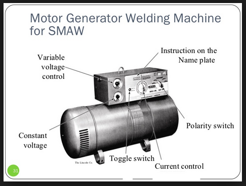

bc.gold   3,406 #17 Posted June 23, 2019 When ever thee three phase motor generator Lincoln welders show up on equipment auction they can be had for less than $100.00, the generator is removed from the electric motor then face plate with a bearing is made up to steady the armature.  I've seen conversions where the generator was belt driven but the most popular is to couple the generator direct to the engine via love joy or a pair of chain sprockets using twin roller chain.  These old copper wound Lincolns are well worth the effort.  1 Share this post Link to post Share on other sites
