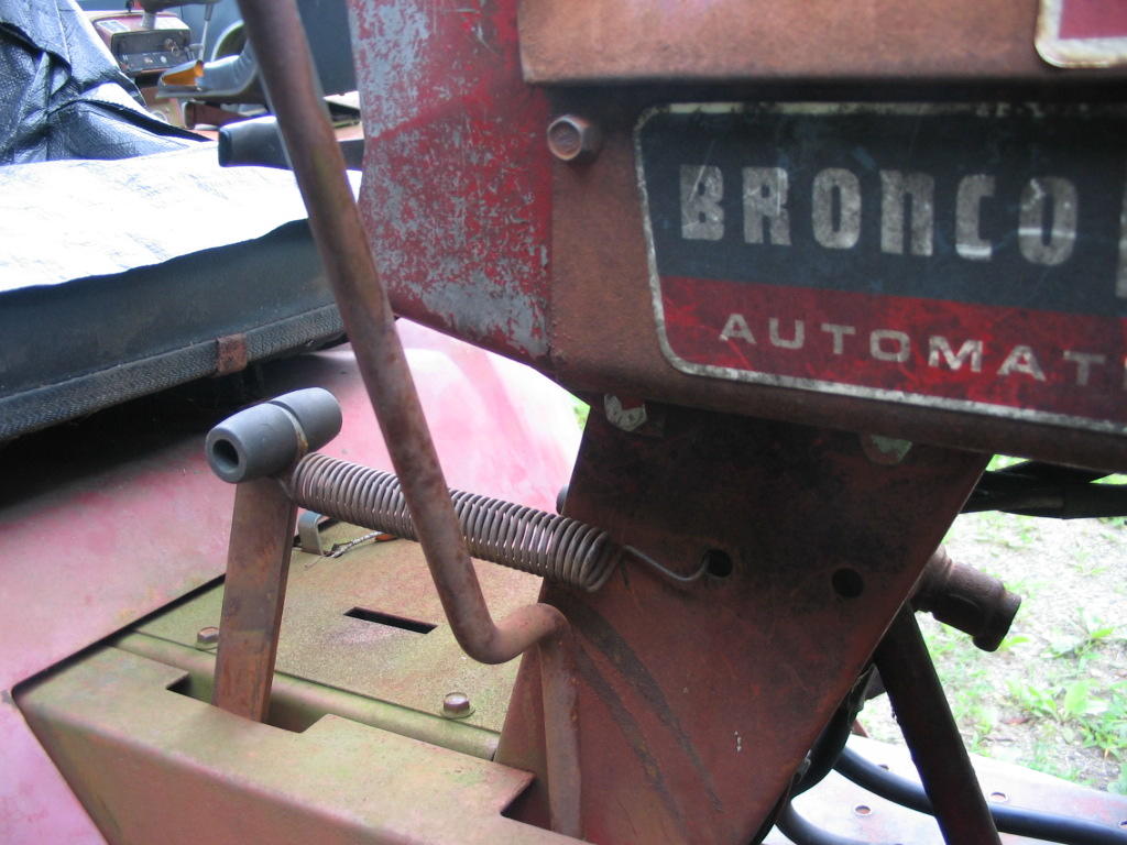

chev0545 238 #1 Posted June 22, 2019 any way to stop the noise from the neutral lever? thanks Share this post Link to post Share on other sites
daveoman1966 3,884 #2 Posted June 22, 2019 Put a sprting on it like on my Bronco 14 here... NO RATTLE. Be sure the spring is under tension when the lever is in the UP position. 2 Share this post Link to post Share on other sites
