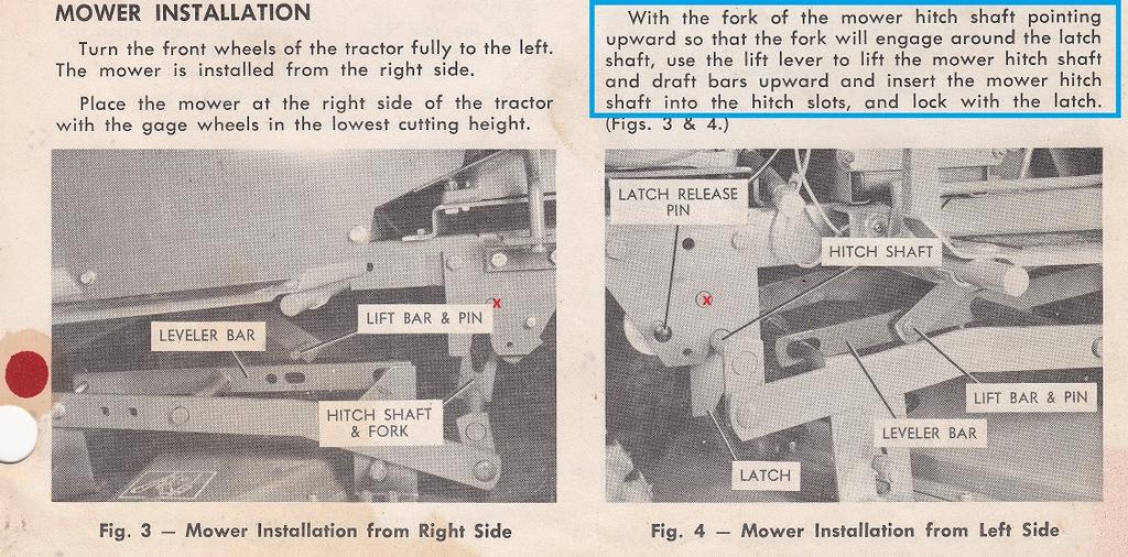

daveoman1966 3,884 #20 Posted June 19, 2019 These 2 pics may help wiith the correct mower deck installation.... It is IMPERATIVE the FORK is engaged as shown in the schematic ....and that the HITCH SHAFT is centered and locked in to the Tach-O-Matic hitch. 1 Share this post Link to post Share on other sites
HueyR9 8 #21 Posted June 19, 2019 7 hours ago, WHX24 said: First off Huey. Aside from the bash in the hood that does look to be a cleaner one than we have seen lately. Second thing is if you don't have the manuals for the tractor or the deck lets get them for you. Put up a pic of the tag under the seat and off the deck so we can get you the right ones. The procedure for installing, removal & adjusting of the deck will be in the manuals and is quite easy once you have done it a few times. You may want to get a engine manual as well if you are even slightly mechanically inclined. All can be found here as well as the some of best 520 mechanics found. Sounds like you might have a dirty carb. A little sea foam may not help but it sure won't hurt. I do not have any manuals for the tractor. I will upload pictures of the tags when I get time. Thank you for the help. Share this post Link to post Share on other sites
HueyR9 8 #22 Posted June 19, 2019 2 minutes ago, daveoman1966 said: These 2 pics may help wiith the correct mower deck installation.... It is IMPERATIVE the FORK is engaged as shown in the schematic ....and that the HITCH SHAFT is centered and locked in to the Tach-O-Matic hitch. Thank you for the diagrams. I do have the deck properly installed at this time. I will retain these though for future reference. Share this post Link to post Share on other sites
