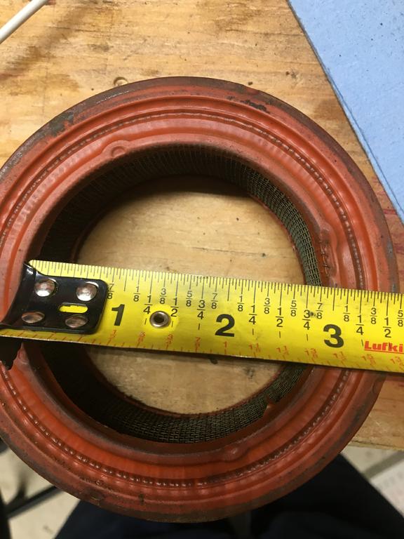

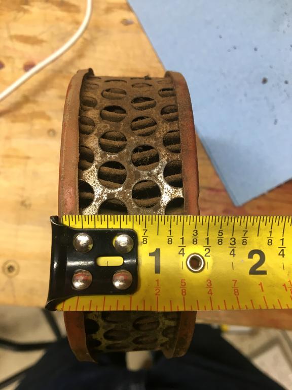

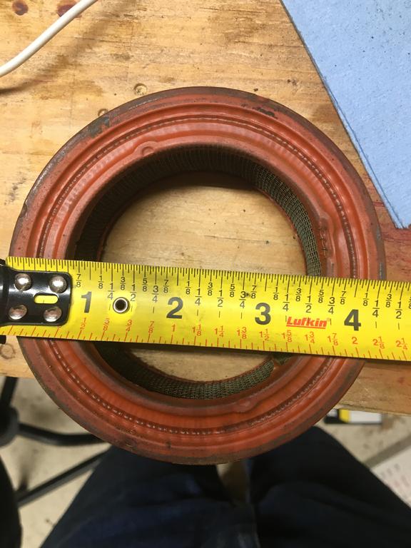

ClassicTractorProfessor 5,455 #1 Posted June 16, 2019 Does anyone know the filter number for the air filter on a K161...working on my 753 and the air filter is one of the last things I need to have her going...I can’t find any numbers on the filter I have and all the ones I’m finding in online searches are the right diameter but too tall to fit in the housing. Share this post Link to post Share on other sites

troutbum70 858 #4 Posted June 16, 2019 I think it is the same filter as my k181 and I just got a new one WIX number #42374. 2 Share this post Link to post Share on other sites
gwest_ca-(File Mod) 12,372 #5 Posted June 17, 2019 Looks like the 3rd one down. Click on the picture Garry 1 Share this post Link to post Share on other sites
71_Bronco 1,072 #6 Posted June 17, 2019 I ordered one from I save tractors. He has them listed by engine model and has the dimensions listed right on the page. 1 1 Share this post Link to post Share on other sites
squonk 47,423 #7 Posted June 17, 2019 2374 sounds right for the Napa # 1 Share this post Link to post Share on other sites
ClassicTractorProfessor 5,455 #8 Posted June 17, 2019 Thanks Garry that’s exactly what I needed...going to save that chart for future reference Share this post Link to post Share on other sites
