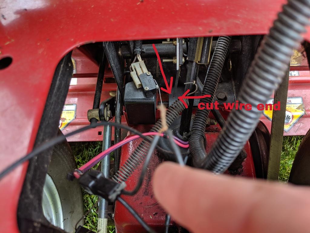

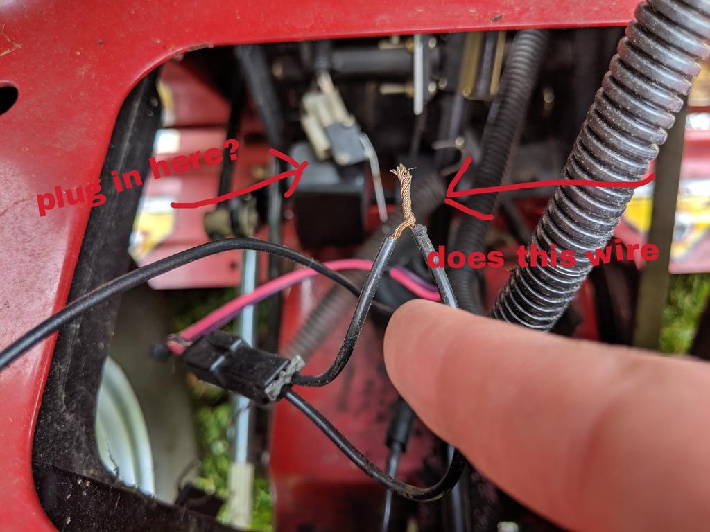

csvt99 173 #1 Posted June 15, 2019 My 314-8 shut off today while mowing. It gave me absolutely nothing when I turned the key to restart. I checked the 10A fuse for the safety system and it was blown. I blew 2 more as soon as I turned the ignition. I know the previous owner disabled the reverse mow safety feature but this is the first I've had a problem all season. I had the wheels off and I sprayed some water around the rear axle to degrease and clean. Looking under the seat I did find this wire action going on. There are two wires twisted together, and it appears they were pulled out of where they were connected to. I'm thinking I can just put it back, but figured I would check with you guys before doing something dumb. Any help? Share this post Link to post Share on other sites
csvt99 173 #2 Posted June 15, 2019 Well I taped up that loose wire and it works now so that must have been causing a short. Now I just have to figure out if it should be plugged back in or not. Share this post Link to post Share on other sites
