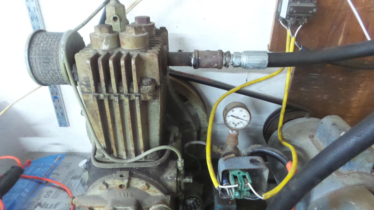

bc.gold 3,406 #8 Posted June 16, 2019 Two stage Quincey on an 80 gallon tank cut out at 180 psi comes back online at 120 psi, regulated air for cabinet blasting depending on what is being blasted between 40 and 60 psi. My buddy a painter of cars and trucks used a long piece of 2inch black gas pipe 12 feet long angled on the shop wall then a foot from the bottom had a T plumbed in with a drain attached, the incoming air came in from the bottom end discharged at the top end. This set up works good at removing moisture from the air. Share this post Link to post Share on other sites
