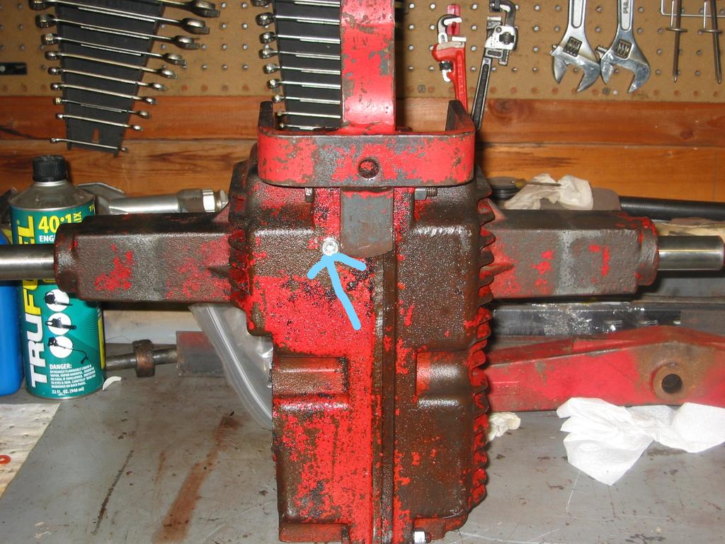

953 nut 68,784 #2 Posted June 15, 2019 Glad to see you will be giving your Grandfather's some love. 6 hours ago, PAguy said: noticed when in 2nd the shifter does not lock tight and seems loose Your shift lever is retained bu a "Dog-point Screw that may need to be tightened. 6 hours ago, PAguy said: the manual says nothing about changing the transmission fluid. Just to check the level. Should it be changed? And if yes what's the best way to do that without causing damage to the transmission? Good idea to replace the gear oil . The drain plug is near the back of the transmission near the trailer hitch. It takes an allen wrench to remove the plug. You should jack up the front end to be sure all the old oil drain. You will need two quarts of 80-90 gear oil to refill, slow and easy when adding the oil or it will burp out and make a mess. 2 Share this post Link to post Share on other sites
ebinmaine 80,456 #3 Posted June 15, 2019 13 minutes ago, 953 nut said: drain plug is near the back of the transmission near the trailer hitch..... On the BOTTOM of the case. It isn't the one on the side. It will be a while draining because of thickness. I give mine overnight if I can but minimum an hour or two. You can also flush the transmission using K1 or diesel and drive it around a bit to help cleanse the gears. It's a great idea to replace the shift boot if you haven't already done so. Keep us posted about the color and consistency of the fluid. It often resembles taffy or caramel which is delicious but not what should be in there. 2 1 Share this post Link to post Share on other sites

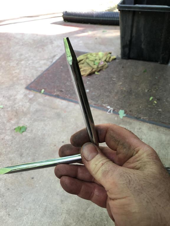

The Tuul Crib 7,354 #6 Posted June 15, 2019 Heres what l use. Its a plumbers tool . lt is just the right size to fit the drain plug. Share this post Link to post Share on other sites
Herder 2,356 #7 Posted June 15, 2019 1 hour ago, The Tool Crib said: Heres what l use. Its a plumbers tool . lt is just the right size to fit the drain plug. Good thinking. Share this post Link to post Share on other sites
