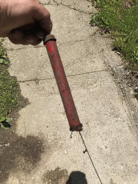

Firebug 267 #1 Posted June 14, 2019 I just found this on my 310-8. Just curious how the tube goes into the transmission. Is the plastic tube threaded in or pressed in. Snapped off pretty flush with the casting. Any thoughts how to get it out without dumping a bunch of junk in there and where would I source a replacement Share this post Link to post Share on other sites

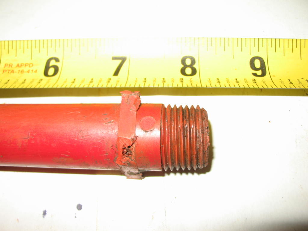

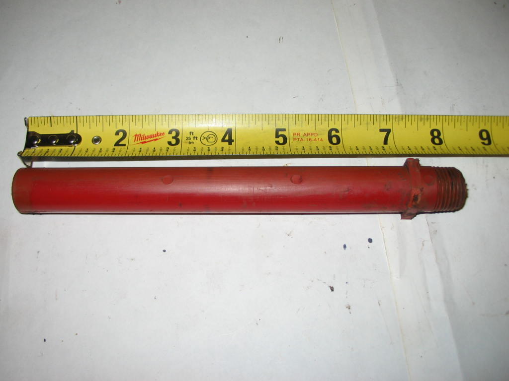

daveoman1966 3,883 #8 Posted June 14, 2019 How long is that filler tube? I have several here to suit.... $15 shipped to you in USA. 1 Share this post Link to post Share on other sites
Firebug 267 #9 Posted June 14, 2019 I will measure it, that’s the same price as eBay but at least I’ll know what I’m getting Share this post Link to post Share on other sites
daveoman1966 3,883 #10 Posted June 15, 2019 The filler tube I have is 8" long...including threads. One of the 4 corners of the 'square' is broken off, but the tube isn't cracked and the threads are all good to go. Share this post Link to post Share on other sites
Firebug 267 #11 Posted June 15, 2019 That looks like it, mine is 7 1/4 including the flats but not the threads. They are hard to measure stuck inside the transmission Share this post Link to post Share on other sites
daveoman1966 3,883 #12 Posted June 15, 2019 I'm thinkin' the tube I have will suit your needs. The one I have is just 7" long to the SQUARE of the tube.... just above the threads. Put $15 to my Paypal account...as SEND MONEY TO A FRIEND..... My account name is: daveoman@windstream.net. Be sure your mailing address is noted in the payment you send., Share this post Link to post Share on other sites
