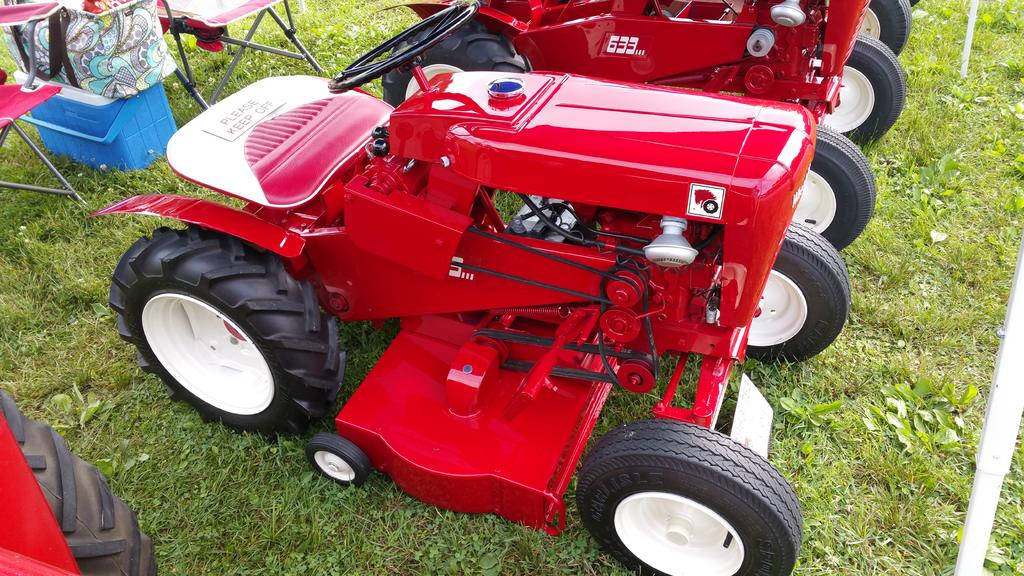

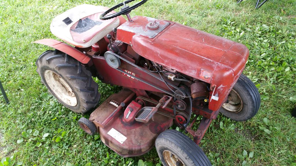

Mike'sHorseBarn 3,660 #1 Posted June 14, 2019 Picking up a square deck at the big show for my 753, but I don't have the correct mounting equipment. Anyone know what all I'll need? I think I even need a different lift link than one for the rounded 36" deck. Anyway, below is a pic of what my tractor had and a picture of what the correct set up looks like. If anyone has what I need let me know that too. Thanks! 1 Share this post Link to post Share on other sites

rjg854 13,311 #3 Posted June 14, 2019 I want to say that they are both the same, I've had both types on my 854. Share this post Link to post Share on other sites
CasualObserver 3,416 #4 Posted June 14, 2019 The mount the same way... put the front pins in the mid-hitch and attach the rear lift link. They just look a little different than each other. Share this post Link to post Share on other sites
squonk 47,890 #5 Posted June 14, 2019 (edited) 4 hours ago, rjg854 said: I want to say that they are both the same, I've had both types on my 854. Same here but on a 704 Sent from the work van whilst on break Edited June 14, 2019 by squonk Share this post Link to post Share on other sites

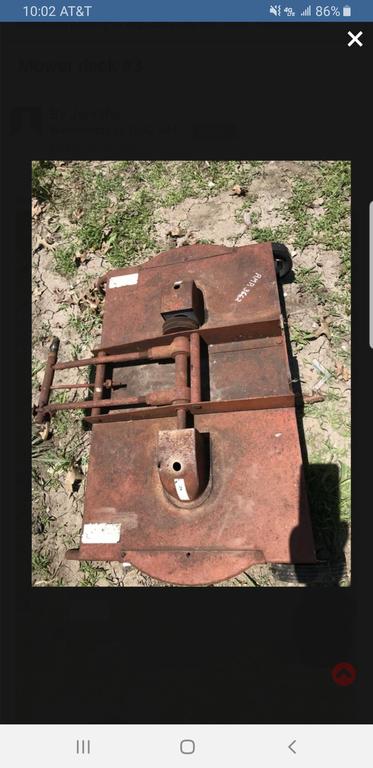

Mike'sHorseBarn 3,660 #7 Posted June 14, 2019 Am I missing a pulley on this deck then? Share this post Link to post Share on other sites
Mike'sHorseBarn 3,660 #9 Posted June 14, 2019 Well crap...lol I do have a perts deck that has that pulley so I'll just have to transfer it. Thanks for the help!! Share this post Link to post Share on other sites
squonk 47,890 #10 Posted June 14, 2019 You will need to raise the cross shaft up on the pulley side to get the belts on too Share this post Link to post Share on other sites
