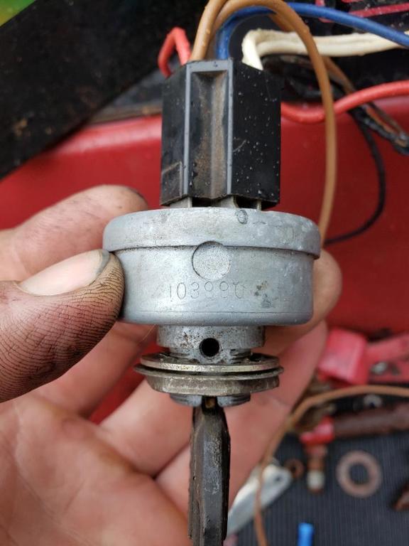

rovert21 5 #1 Posted June 13, 2019 Ok, so I have a 314-8 tractor that I acquired a few years ago and finally starting to work on it. Since I've owned the tractor it has never started with the key, only buy jumping across the solenoid. I've come to realize that one of the terminals on the ignition either burnt off or rusted off, so I got a used one and installed it. I also replaced the starter solenoid as it has deteriorated from starting with screwdriver. I put on the new parts excited to finally start this thing with a key, but when I turn the key I get smoke. The ground wire going from the ignition switch to the chassis ground melted. What would cause this? I know there could be a lot of variables, but electricity is like voodoo to me so I'm looking for some help. Could the ignition switch I got be internally shorted, or could it be the wrong one. Could the solenoid be the wrong one or defective? I've attached a picture of the wiring diagram for the tractor. Share this post Link to post Share on other sites
ZXT 2,401 #2 Posted June 13, 2019 (edited) Look on the back of each of the switches and see if the pin out is the same. I'd almost bet that you have a different part # switch that uses the same connector but has the wires located differently. Looking at the diagram you posted, assuming it is for your tractor shows that you have a "M" post on your ignition switch, since it has a magneto. I'm going to guess that the switch you installed has an "I" instead, which is for a battery ignition tractor. Do you know what year the tractor is? That would help in identifying which switch you need. Edited June 13, 2019 by ZXT 1 Share this post Link to post Share on other sites
ebinmaine 75,779 #3 Posted June 13, 2019 Wrong switch would be my first guess as well. Don't be afraid of wiring. Electricity moves alot like water. You just need the right switches instead of valves. If you could post your tractor's numbers @gwest_ca or others could get you the correct verified schematic. Also a few pics would help us see what you see. 1 Share this post Link to post Share on other sites
953 nut 63,071 #4 Posted June 13, 2019 Sorry to hear about your problem, but you have come to the right place. The ignition switch for your 314-8 would be part number 103 991 and can be found on or places like tractor supply. I hope that the coil on your engine didn't get hit with 12 volts because that will tend to damage them.. There is a four wire plug going to your engine, two wires (orange and tan) go to the oil level switch, blue to the mag. and white/purple to the charging system. Disconnect this plug and use a timing light if you have one or remove the spark plug and with the wire attached lay it on the head to see if you have spark when the engine is cranked over. If you do have spark then say a little prayer of thanksgiving. If there is no spark then more testing is needed. This service manual should be helpful. Share this post Link to post Share on other sites

rovert21 5 #10 Posted June 13, 2019 This is the used switch i tried to use 103990. I see no legible numbers on original. 1 Share this post Link to post Share on other sites
ebinmaine 75,779 #11 Posted June 13, 2019 9 hours ago, 953 nut said: ignition switch for your 314-8 would be part number 103 991 Mystery solved. Incorrect switch. Share this post Link to post Share on other sites

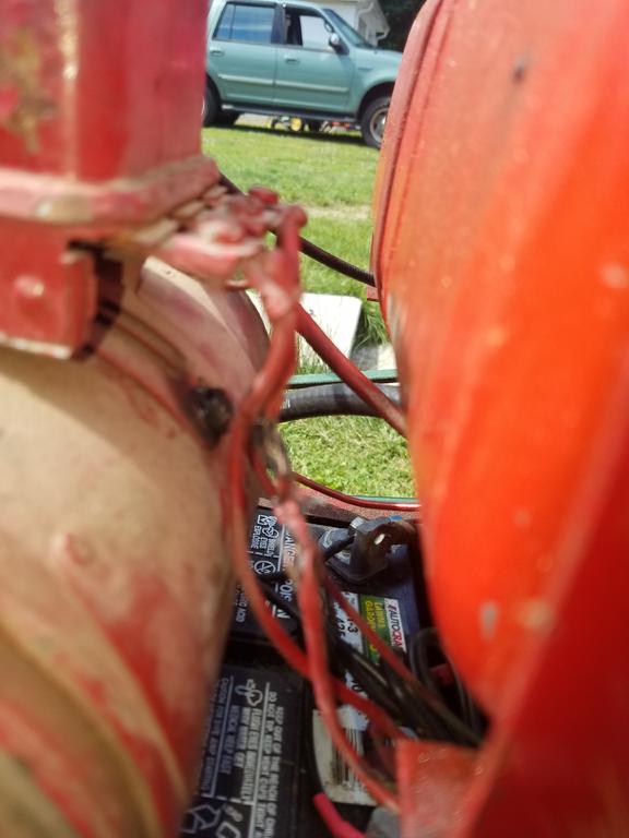

adsm08 3,871 #14 Posted June 13, 2019 25 minutes ago, ebinmaine said: I would add to that good bit of information by reminding you that if electricity can find a path, it will. If you don't have a large enough ground but you do have a small one elsewhere, you'll send a bunch of current through the small one and melt it. Ask me how I know... Sometimes even where there isn't supposed to be one: Share this post Link to post Share on other sites
ebinmaine 75,779 #15 Posted June 13, 2019 1 minute ago, adsm08 said: Sometimes even where there isn't supposed to be one: Ouch!!! Share this post Link to post Share on other sites
adsm08 3,871 #16 Posted June 13, 2019 57 minutes ago, ebinmaine said: Ouch!!! Meh, took more time to find my wire working multi-tool than it did to fix. I routed the throttle cable wrong while messing with it last week, it pushed one of those wires up against the regulator bolt there, and it rubbed while mowing. I lost the wires to and from the amp meter, and the power wire to the lighter socket. Share this post Link to post Share on other sites

gwest_ca-(File Mod) 11,849 #18 Posted June 14, 2019 Here is the required switch. Click on the picture and on the pictures on the next page. Describes how to check the switch. Garry 1 Share this post Link to post Share on other sites
