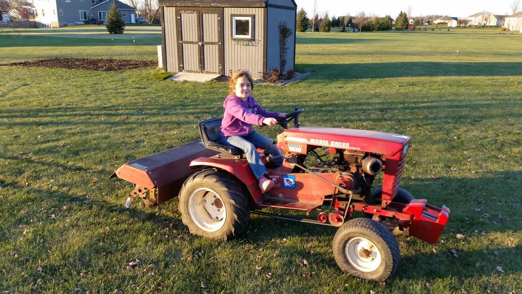

JoeM 10,157 #4 Posted June 13, 2019 I used some steel plates mounted to a removable bracket on the front. Could even use old barbell weights. 50 pounds is nice. This is a 312-8 and that is my neighbor running the tiller. 1 Share this post Link to post Share on other sites

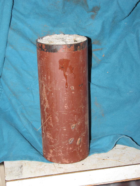

CCW 1,519 #5 Posted June 13, 2019 Was at a house construction site recently and there were five of these concrete steel column sections. They are the left over pieces that are cut from the columns that are in the basement supporting the carrying beams. Site boss said they were being thrown out and I could have them. Four are now mounted to the front of my 312-8. Each weighs approximately 15 pounds adding 60 pounds, plus or minus. Share this post Link to post Share on other sites
