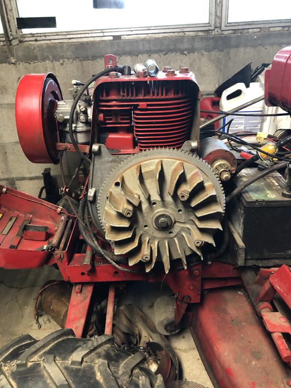

520hC-120 136 #5 Posted June 12, 2019 (edited) Update I checked the m wire and it is fine. The points I cleaned with a dollar bill. Still no spark. I took the flywheel shroud off and looked, there is no coil. Do I have to take the flywheel off? Edited June 12, 2019 by 520hC-120 Share this post Link to post Share on other sites
953 nut 69,558 #6 Posted June 12, 2019 30 minutes ago, 520hC-120 said: Do I have to take the flywheel off? The coil and the magnets that work with it are behind the flywheel. Use a Harmonic balance puller to remove it. 2 Share this post Link to post Share on other sites

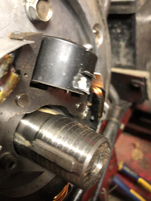

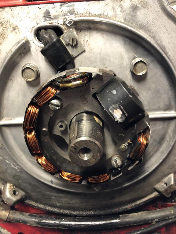

520hC-120 136 #10 Posted June 19, 2019 I got the tool and have the flywheel off. I looked through that manual and can’t seem to find the pages I’d need. Anyways it seems that my stator has an issue but I don’t really know as I’ve never done this before. I just need to know if I should get a whole new assembly or try to fix this. And how to do so. Share this post Link to post Share on other sites

520hC-120 136 #12 Posted June 19, 2019 (edited) Thanks I went through the tests and found I need a new stator. I looked on eBay and only found ones that looked like the one in this picture. But mine looks a lot different. What do I search for and does anyone know where I can get one. Edited June 19, 2019 by 520hC-120 Share this post Link to post Share on other sites
