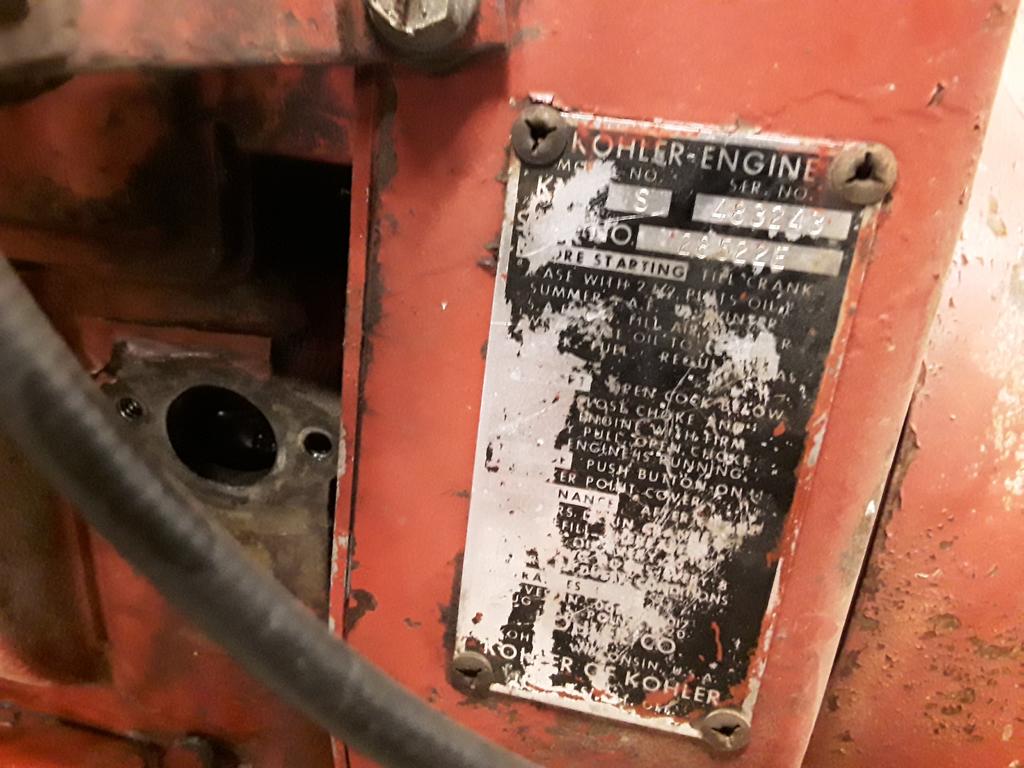

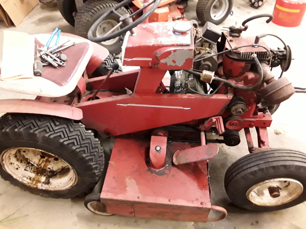

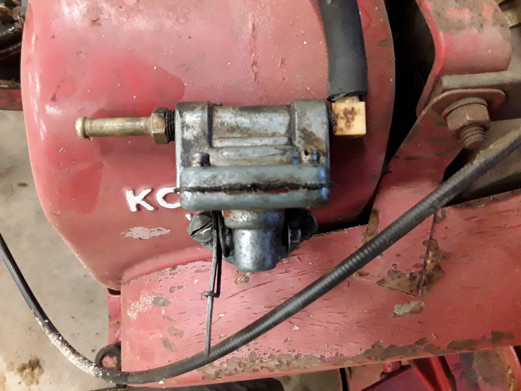

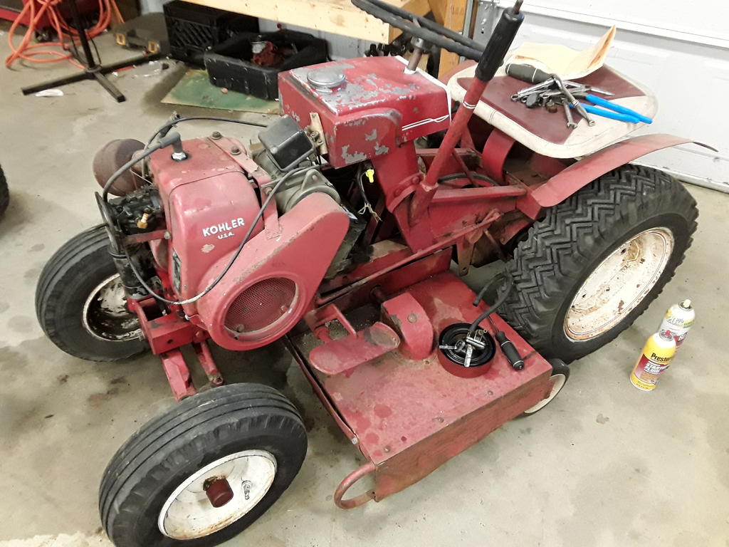

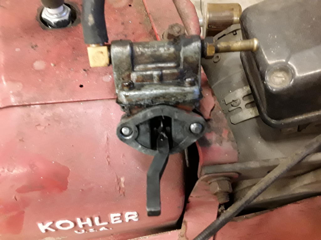

mhlmeader 689 #1 Posted June 12, 2019 Hi folks, picked this up tonight. Hadn't been run in a few years. I got her started...ran like a kitten!!!! Problem is fuel was just pouring out from behind the fuel pump. Correct me if I'm wrong, but this is a k161 engine, I do believe?.?. Model 701 tractor. I shut her down before I combusted accidently. Is there a rebuild kit for this particular pump? Or am I gonna have to go with something new? Could ya point me in the right direction, thanks all!! 1 Share this post Link to post Share on other sites
WHX?? 55,703 #2 Posted June 12, 2019 (edited) Holy crap Buff that's a dang nice looking 701!... Little rough around the edges sure but that's to be expected. I'll be right over to get it! Fuel pump is totally rebuildabe or replace with a plastic one ... that girl deserves a rebuild kit to try and stay orginal plus that pump has the primer lever. The fellas will post a link to get the rebuild kits. Bigger worry might be the way the regulator is jammed up against the fuel tank. Don't much care for that. No matter you got one to be saved there! What kinda shape is the hood in? Edited June 12, 2019 by WHX24 1 Share this post Link to post Share on other sites
Achto 31,310 #3 Posted June 12, 2019 (edited) This is the only place that reproduces rebuild kit for the metal body Kohler pumps. Or you can replace it with a new plastic one, yes all the new ones are plastic even the Kohler ones. http://www.then-now-auto.com/kohler-fuel-pumps-2/ Edited June 12, 2019 by Achto 3 Share this post Link to post Share on other sites

Achto 31,310 #5 Posted June 12, 2019 21 minutes ago, mhlmeader said: Definitely get that volt regulator turned around so that the terminals are not mashed against the fuel tank. 3 Share this post Link to post Share on other sites
mhlmeader 689 #6 Posted June 12, 2019 I should mention, the pump seemed to be working just fine, but it was leaking thru pretty good....GAS...WAS...EVERYWHERE....it could have pumped fuel into the tractor setting next to it!! 2 Share this post Link to post Share on other sites
mhlmeader 689 #7 Posted June 12, 2019 2 minutes ago, Achto said: Definitely get that volt regulator turned around so that the terminals are not mashed against the fuel tank. Yes, thankyou...its a little askew right now! 1 Share this post Link to post Share on other sites

mhlmeader 689 #9 Posted June 12, 2019 8 minutes ago, Achto said: This is the only place that reproduces rebuild kit for the metal body Kohler pumps. Or you can replace it with a new plastic one, yes all the new ones are plastic even the Kohler ones. http://www.then-now-auto.com/kohler-fuel-pumps-2/ Thankyou!! 2 Share this post Link to post Share on other sites

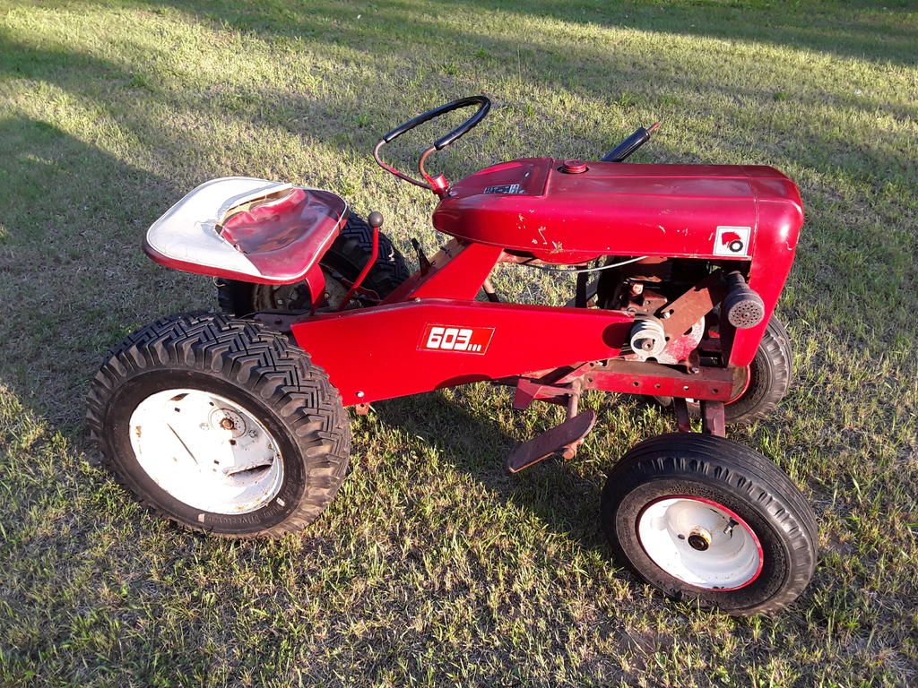

WHX?? 55,703 #10 Posted June 12, 2019 Do we have pics of the 603??? Get the oil changed out and refill if gas was getting into the crankcase 2 1 Share this post Link to post Share on other sites
WHX?? 55,703 #11 Posted June 12, 2019 12 minutes ago, mhlmeader said: Yes, thankyou...its a little askew right now! Again to be expected....Wil give you a few minutes to get things straighten out! 2 Share this post Link to post Share on other sites
mhlmeader 689 #12 Posted June 12, 2019 1 minute ago, WHX24 said: Do we have pics of the 603??? Get the oil changed out and refill if gas was getting into the crankcase Yes, I started a thread in the tractor section, but here's ya go... 1 1 Share this post Link to post Share on other sites
