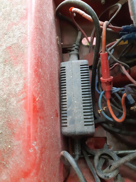

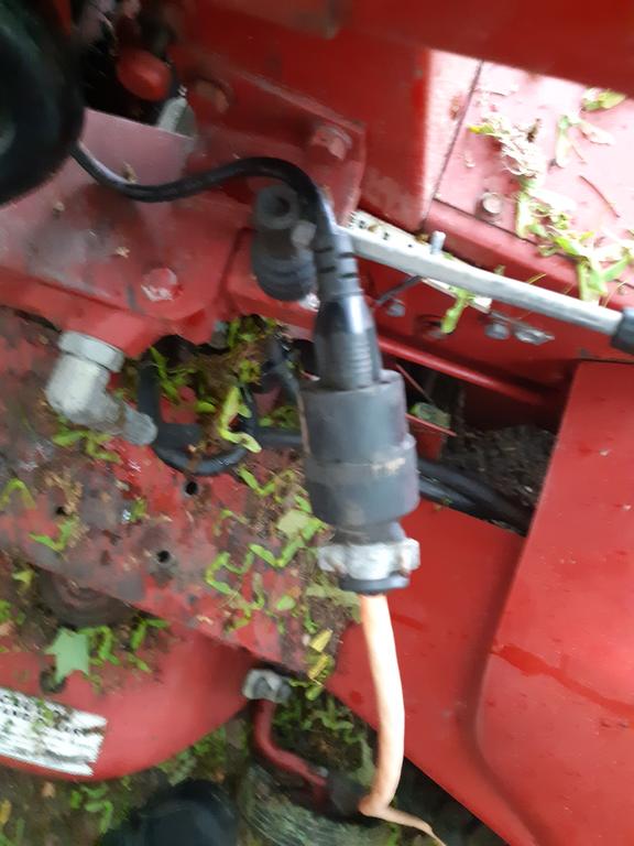

The Gman 476 #1 Posted June 10, 2019 For those who have a plethora of horses plus batteries, or not. Over the years I've kept or found those 12 volt power converts, mostly from cordless phones but other things as well. I wire them to the battery with an on/off switch or a fuse. When it's time to put most of the heard away for the winter, in the shed or just covered up I run a few power bars, plug them in and say "see ya come spring" I've been doing this for about 5 years now and leave them on permanently. I use ones that only put out .5-.7 amps. I thought of getting a bunch of battery minders, they run $10 to $15 up here north of the boarder. Works great. Anybody else tried this? 3 1 Share this post Link to post Share on other sites

The Gman 476 #5 Posted June 11, 2019 I hear ya...... they are plugged into a timer that set to 6 hrs on, 18hrs off. 1 1 Share this post Link to post Share on other sites
