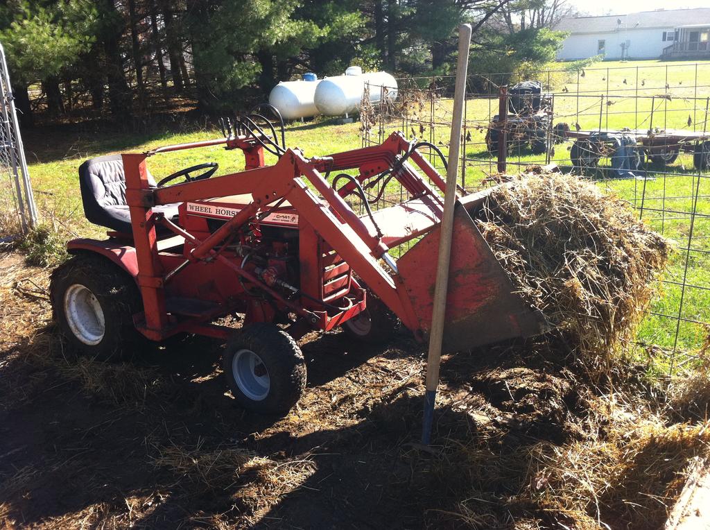

MalMac 1,337 #10 Posted June 11, 2019 (edited) Here is one of mine on a C141 doing the chore you described. Loading out manure. Also the loader got transferred to a 414-8 with steering reduction on it. The loaders through the years were made by different companies. This one is a Ark, the last ones were Kwik-way. Earlier ones I believe Johnson’s. Edited June 11, 2019 by MalMac 2 1 Share this post Link to post Share on other sites
