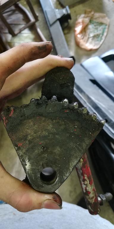

Brent Fabian 57 #1 Posted June 7, 2019 I believe this is called the Sector gear for my wheel horse suburban. I only have 1 to use with both my tractors, and I discovered today one of the teeth is missing. Anybody have new ones for sale or a way to get a new one? Share this post Link to post Share on other sites

953 nut 70,344 #4 Posted June 7, 2019 If you can weld and have the patience to do so you could build up the teeth that are gone and then grind them to the proper shape. Sort of like going to the dentist for a crown. 7 1 Share this post Link to post Share on other sites

Brent Fabian 57 #10 Posted June 8, 2019 5 hours ago, 953 nut said: If you can weld and have the patience to do so you could build up the teeth that are gone and then grind them to the proper shape. Sort of like going to the dentist for a crown. I was thinking of tracing the gear pattern and creating a copy so I have one for both my tractors 2 Share this post Link to post Share on other sites
