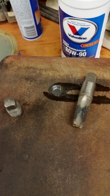

mhlmeader 689 #1 Posted June 7, 2019 Hi folks, in the process of unsticking a very stuck tranny drain plug I marred it up pretty darn good. Anybody know what replacement size to get? And where? Thanks 1 Share this post Link to post Share on other sites
ebinmaine 77,517 #2 Posted June 7, 2019 1 hour ago, mhlmeader said: Hi folks, in the process of unsticking a very stuck tranny drain plug I marred it up pretty darn good. Anybody know what replacement size to get? And where? Thanks I'm not familiar with the transmission you have as all of ours are newer but if you take it to a hardware store I think that's just considered a standard replacement part. They should be able to match it up. 1 Share this post Link to post Share on other sites
WHX?? 55,194 #3 Posted June 7, 2019 (edited) I'm thinkin 1/4 NPT here Buff Bill . You can get the hex head ones but a square head plug will work good. Oh and Ace is the place.... or any hardware store or big box. Hex heads from McMaster. Edited June 7, 2019 by WHX24 1 Share this post Link to post Share on other sites

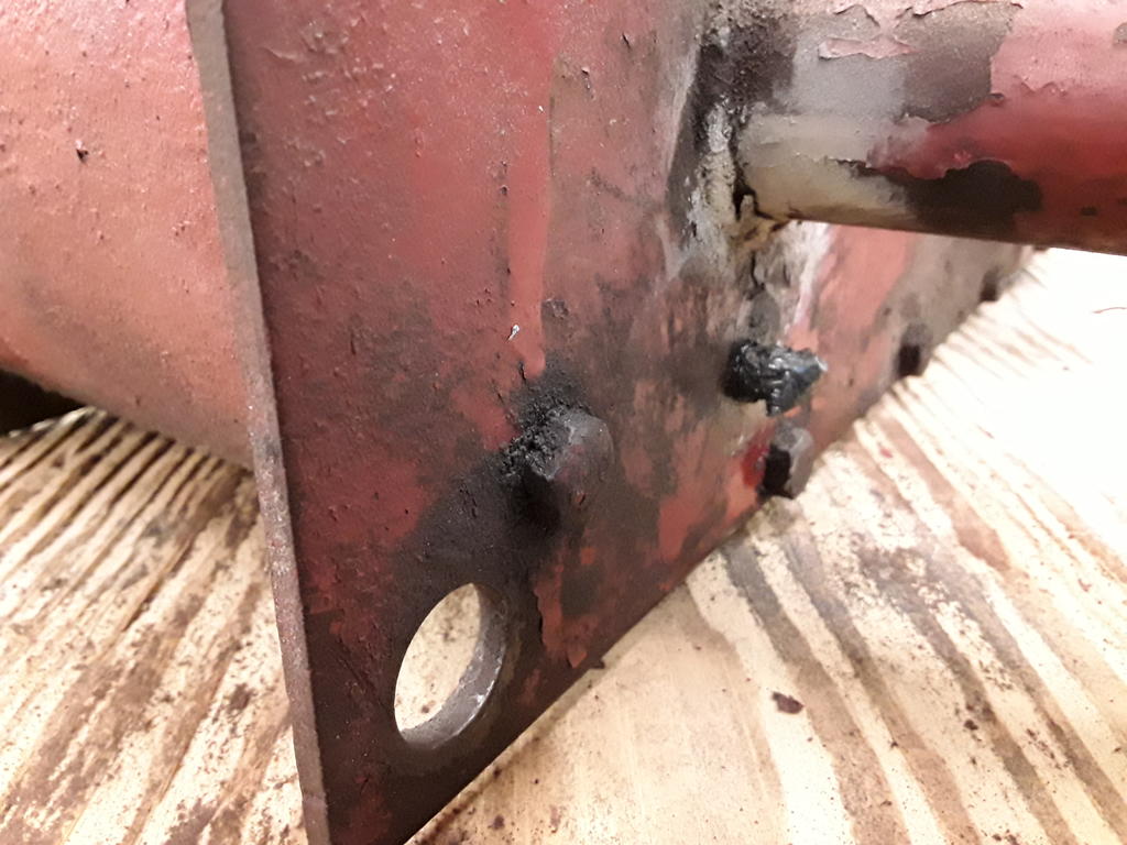

mhlmeader 689 #5 Posted June 7, 2019 4 minutes ago, gwest_ca said: I have always thought they did not have a drain plug. Garry Yes sir, sure do....this is what's left of mine after I muffed it up, and then tack welded some gooble goop on it to get it to finally come out...I know, I know.....amateur hour at the old shop today!!!:) 1 Share this post Link to post Share on other sites

Achto 31,114 #9 Posted June 8, 2019 (edited) 2 hours ago, mhlmeader said: Yes sir, sure do....this is what's left of mine after I muffed it up, and then tack welded some gooble goop on it to get it to finally come out...I know, I know.....amateur hour at the old shop today!!!:) That is actually the fill level plug. You need to remove one of the lower bolts that hold the tranny side plate to the center cast piece. This will allow the oil to drain out. When you fill the tranny, add oil until it runs out of the hole that you removed that plug from. The plug is an 1/8" npt pipe plug. Edited June 8, 2019 by Achto 6 Share this post Link to post Share on other sites
mhlmeader 689 #10 Posted June 8, 2019 3 minutes ago, Achto said: That is actually the fill level plug. You need to remove one of the lower bolts that hold the tranny side plate to the center cast piece. This will allow the oil to drain out. When you fill the tranny, add oil until it runs out of the hole that you removed that plug from. The plug is an 1/8" npt pipe plug. Ahhhh, ok....thankyou 2 Share this post Link to post Share on other sites
WHX?? 55,194 #11 Posted June 9, 2019 Correct thinkin now that I have a cocktail in my hand ...I drill the bottoms and install a 1/4 NPT magnetic plug..... On trannies I have to open.. @stevasaurus would approve of removing a case bolt to drain. I could swore one of mine had a drain plug on the bottom??? Or am I thinkin a fill plug on the top?? Hang on whilst I refresh my glass! 3 Share this post Link to post Share on other sites
Racinbob 12,804 #12 Posted June 9, 2019 (edited) Dunno Jim. No drain plug on the bottom and there's already holes in the top for filling. I couldn't get the level plug out on mine either but then again, I didn't try too hard. The only reason I tried at all was so I could put a stainless plug in it. Case bolt to drain and 1 1/2 quarts of go juice and be done with it. Edited June 9, 2019 by Racinbob 3 Share this post Link to post Share on other sites
