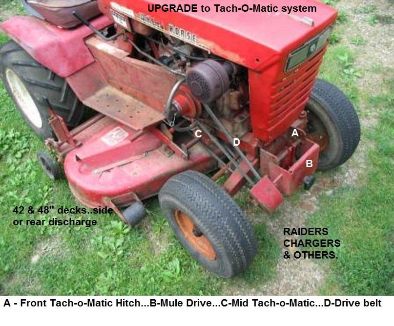

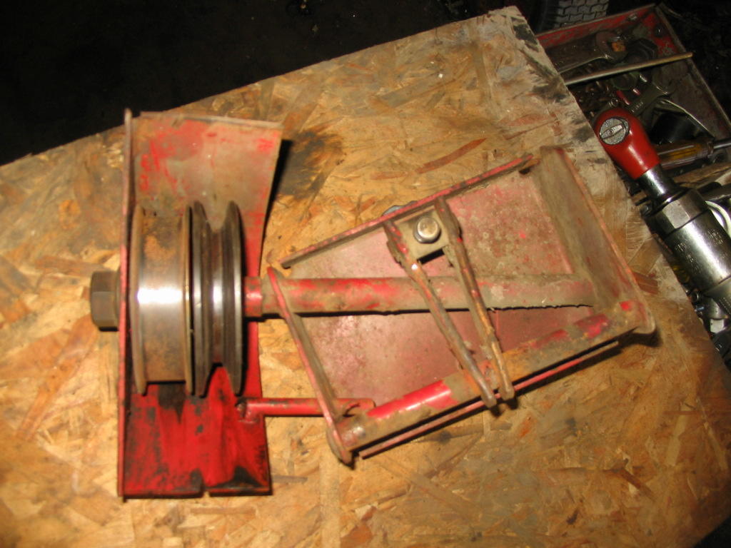

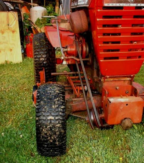

daveoman1966 3,884 #2 Posted June 7, 2019 (edited) Are you sure you have the correct belt? It should be OEM # 102741... 97" long x 0.5"wide. The MULE DRIVE... V pulley on inside...FLAT IDLER pulley outside. 1)Put belt on deck center pulley. 2) with cover off of front mule drive, route belt out around the V and Flat Idler pulleys. 3) loop belt around the INNER most V of the PTO bell. 4) use Knob on front mule drive to tighten the belt. 5) install cover back onto mule drive. Shown here is a 42" deck and the belt routing is exactly the same for a 36 or 48" deck. Edited June 7, 2019 by daveoman1966 1 Share this post Link to post Share on other sites
