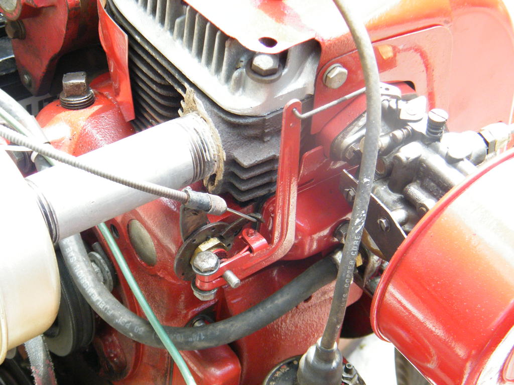

adsm08 4,352 #1 Posted June 6, 2019 Today when I tried to start mowing I had a slew of issues with the 855. The first of which, was that she didn't want to run well. She would flag and stall quickly at idle, would run longer with the throttle cable pulled all the way out, but still stalled, and would run all day if I worked the throttle directly by hand and held it wide open. Now I have suspected from day one that I wasn't getting the full range of the throttle. All the way in she won't idle, just stall quick. with the cable out as far as I could get it she seemed low on power, and didn't seem to spin as quick as it should. The throttle has also been extremely stiff since I bought it, which I chalked up to the decade long hibernation, and hoped it would loosen with use. So far it hasn't loosened much, but I have gotten a little more movement out of it. So today I decided to see what was sticking. I removed the throttle cable from the governor arm, pulled it in and out, it moves freely, put it back on, I now have 1/2 inch of movement on the knob from "she's dead" to over revved. So messed with it a bit more, and got idle, but the engine seemed to run too slow at "full throttle". So I reset the governor, which should have reset the throttle, but it still isn't quite right. I can make it idle, but wide open still seems a little high, so I'm thinking the cable operated stop for the governor is out of whack. So does anyone have any advice on setting the throttle cable position? Unfortunately my hand tach is MIA at the moment, so I don't have actual RPM numbers., just what my calibrated ear is telling me. I do know that the book says ~3600 RPM is where it should be at full throttle. If I get some time tomorrow I'll dig around for my tach. My voltmeter is supposed to have a tach function, which I can't remember how to access, but I'm not sure it will read a single cylinder engine accurately. Share this post Link to post Share on other sites

stevasaurus 23,662 #4 Posted June 7, 2019 !st...read the manual on how to set the governor...set it according to the book and you are done with it. 2nd...the cable can be set to change the range from low to high idle to higher and not so low idle, to lowest and not so high by where you tighten that screw on the sheath of the cable. This makes the difference of how far the cable itself pushes the arm on the carb. 3rd...you could just have a carb issue and need cleaning or adjusting. See that screw in the top of the picture?? Count the turns and bottom that screw out gently. Then take the screw out and you will see some small holes near the end...use a wire and some carb clean and clean those holes. Then put the screw back in...bottom it out and back out the number of turns to where it was (about 2 1/2 turns). Adjust for most RPMs. 4th...one other thing...at the top left of this picture, you can see 3 holes in that carb arm and the cable in one of them. I have seen that cable in any one of those 3 holes and it would also adjust how far you move the throttle depending on which hole it is in. Share this post Link to post Share on other sites
stevasaurus 23,662 #5 Posted June 7, 2019 A couple of other thoughts...check, clean and gap or replace your spark plug. Also, check the points for pitting and for gap 0.020. The points control the timing of your engine. The engine will run rough and not idle if the points are not correct Share this post Link to post Share on other sites

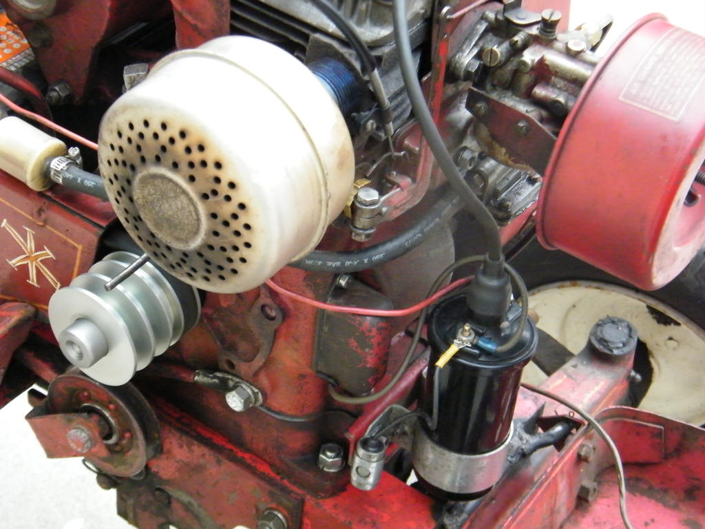

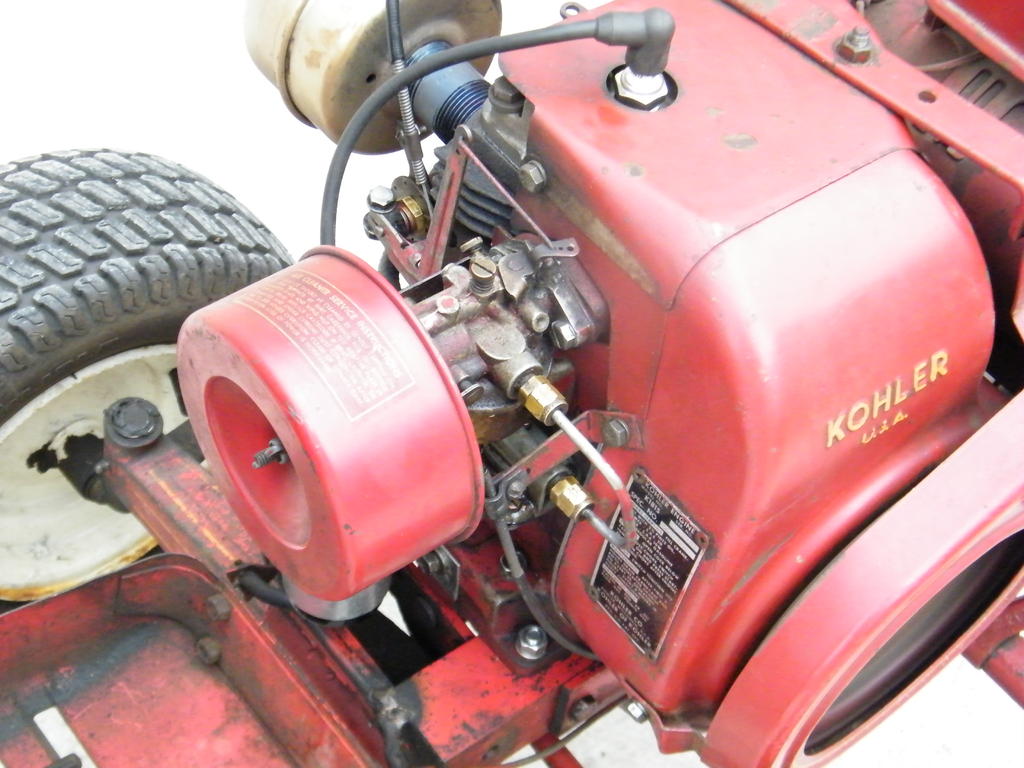

stevasaurus 23,662 #13 Posted June 8, 2019 The linkage on these horses is not always the same as the pictures...even when you are just talking K-181s. I have an 857 and an 876, I think they should be the same as your 855...being they are the short frame square hoods. See what you think. The 857... the 876... Share this post Link to post Share on other sites
adsm08 4,352 #14 Posted June 8, 2019 Those do look a lot like what I have. 1 Share this post Link to post Share on other sites
