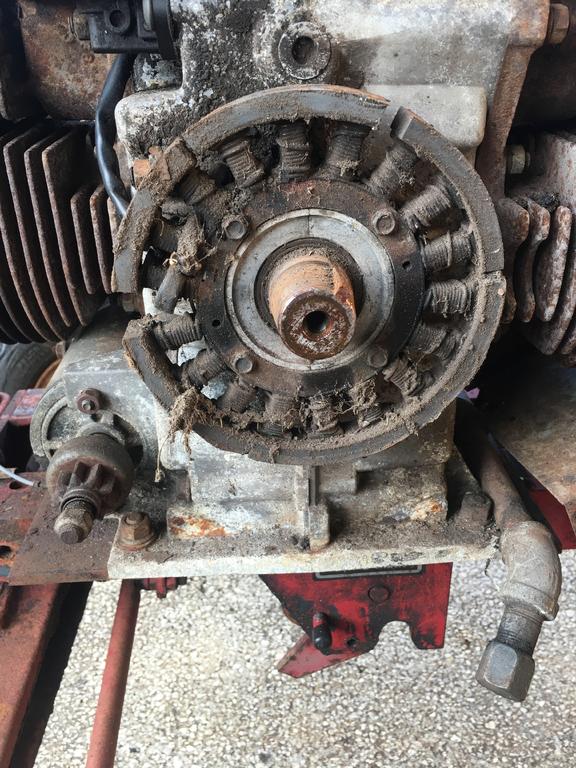

953 nut 66,553 #10 Posted June 5, 2019 7 hours ago, Mudrig150 said: been sitting outside, but in the kid's little shed. Could be the mice have built enough nests under the flywheel cover to keep it from turning. You need to remove them and clean the cooling fins anyway. 1 Share this post Link to post Share on other sites
19richie66 17,892 #11 Posted June 6, 2019 Check the flywheel magnets. Had all of them come off a flywheel. Ran good and then when I shut it off, a small piece caught a pole on the stator. Instant lock up. Moved back and forth a little but when you hit the key, it jammed and acted like it was a broke rod. Toasted the stator but I have another for it. Pulled a spare flywheel and it was the same way. 1 2 Share this post Link to post Share on other sites
