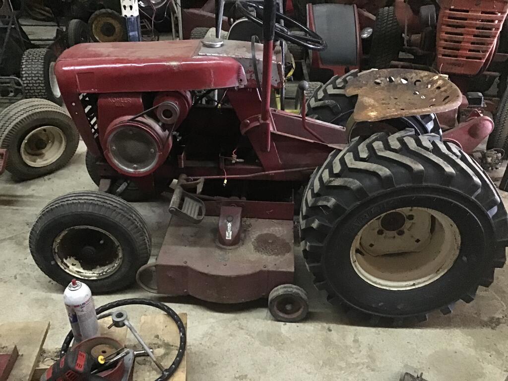

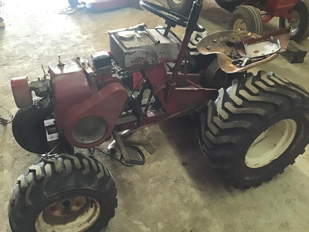

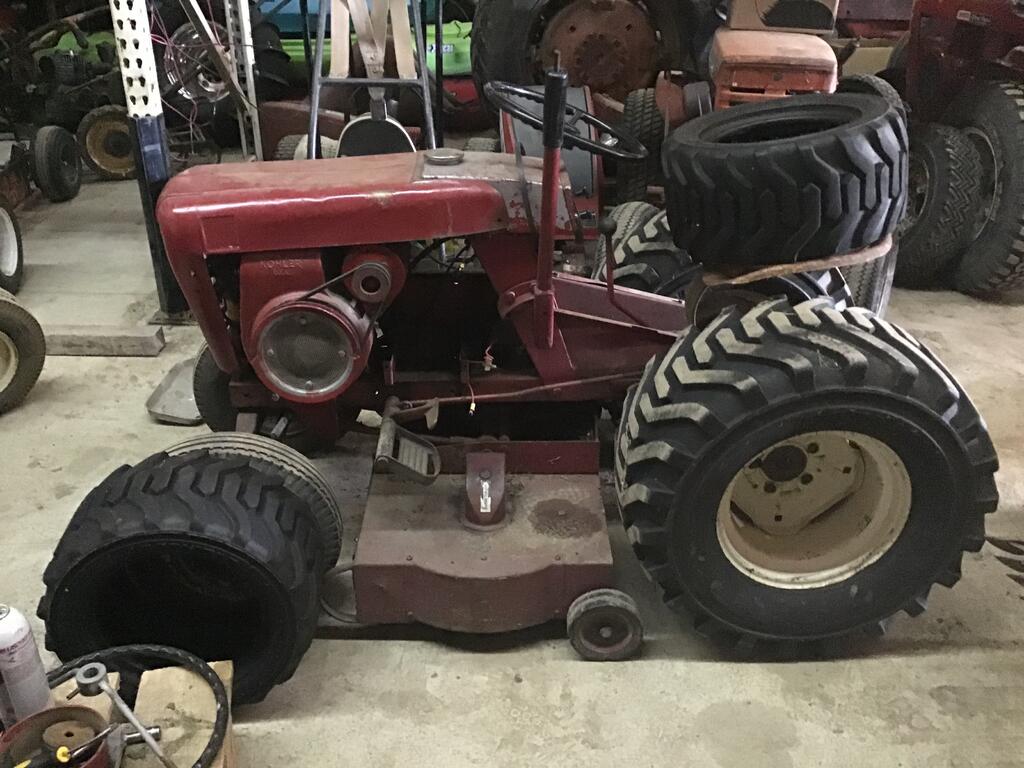

Pullstart 71,016 #56 Posted June 24, 2020 I received these Carlisle tires as partial payment for services rendered at my Aunt and Uncle’s house. They were on his SCUT John Deere but tire up his yard too bad while mowing. I’ll need some hubs to mount a set of rear Wheel Horse 10” wheels up front, but I like ‘em! 8 Share this post Link to post Share on other sites
ebinmaine 80,102 #57 Posted June 24, 2020 Them are rugged. You can get stubs and hubs on etrailer.com super reasonable 1 Share this post Link to post Share on other sites
Pullstart 71,016 #58 Posted June 24, 2020 17 minutes ago, ebinmaine said: Them are rugged. You can get stubs and hubs on etrailer.com super reasonable LIGHT BULB! What about using a set of 1” hubs... and running a 3/4“ x 1” Bronze/brass bushing!? 2 1 1 Share this post Link to post Share on other sites

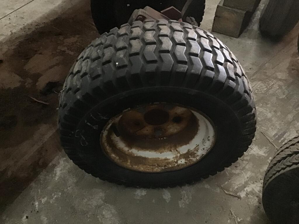

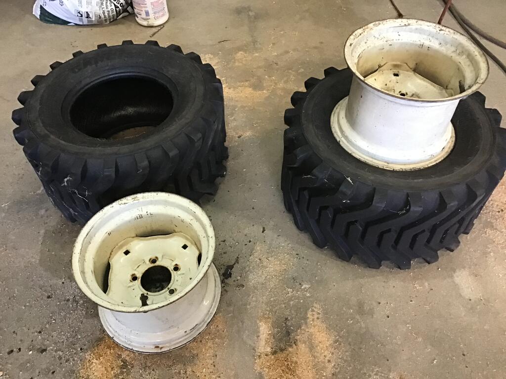

Pullstart 71,016 #59 Posted June 24, 2020 Here are the 10” wheels I’ll use. They have 20x6-10 tires currently. Share this post Link to post Share on other sites
Tractorhead 9,217 #60 Posted June 24, 2020 Or maybe flat roller bearings if possible. Rear tyres looking dang cool ! maybe useful on the Loader horse 1 1 Share this post Link to post Share on other sites

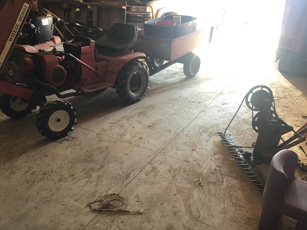

Pullstart 71,016 #62 Posted June 24, 2020 Oh... yeah! I must admit! I might have to change Poppy’s name to @Skipper Jr! 1 2 1 2 Share this post Link to post Share on other sites

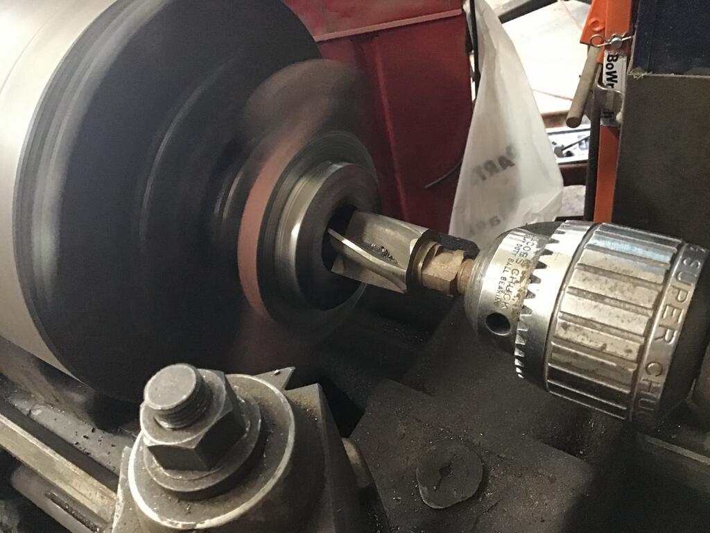

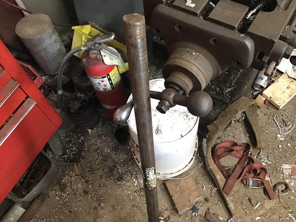

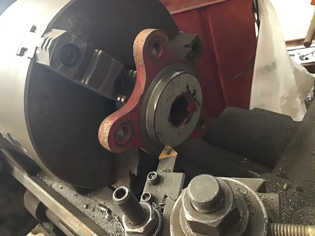

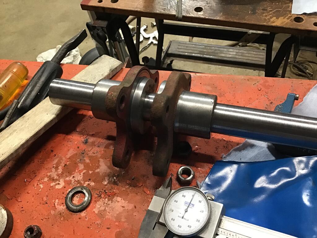

Pullstart 71,016 #64 Posted June 24, 2020 I know Uncle Jim’s gonna kill me for this, but I’m modifying these hubs into front hubs by boring them to 1-1/4” and using some solid round bar to slide onto the spindles. 2 1 1 Share this post Link to post Share on other sites

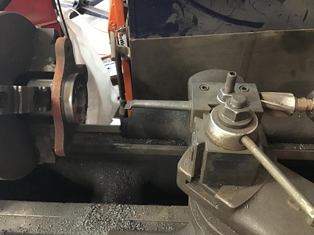

Pullstart 71,016 #65 Posted June 24, 2020 Taking the centering hub down from 3.125 to 2.500” 1 Share this post Link to post Share on other sites
Tractorhead 9,217 #66 Posted June 24, 2020 Nothing beats a good Equippment Share this post Link to post Share on other sites
Pullstart 71,016 #67 Posted June 24, 2020 Boring it to size. I am at 1.210 and will bring it to 1.240 with the calipers, then switch to inside micrometer stuff. 4 Share this post Link to post Share on other sites

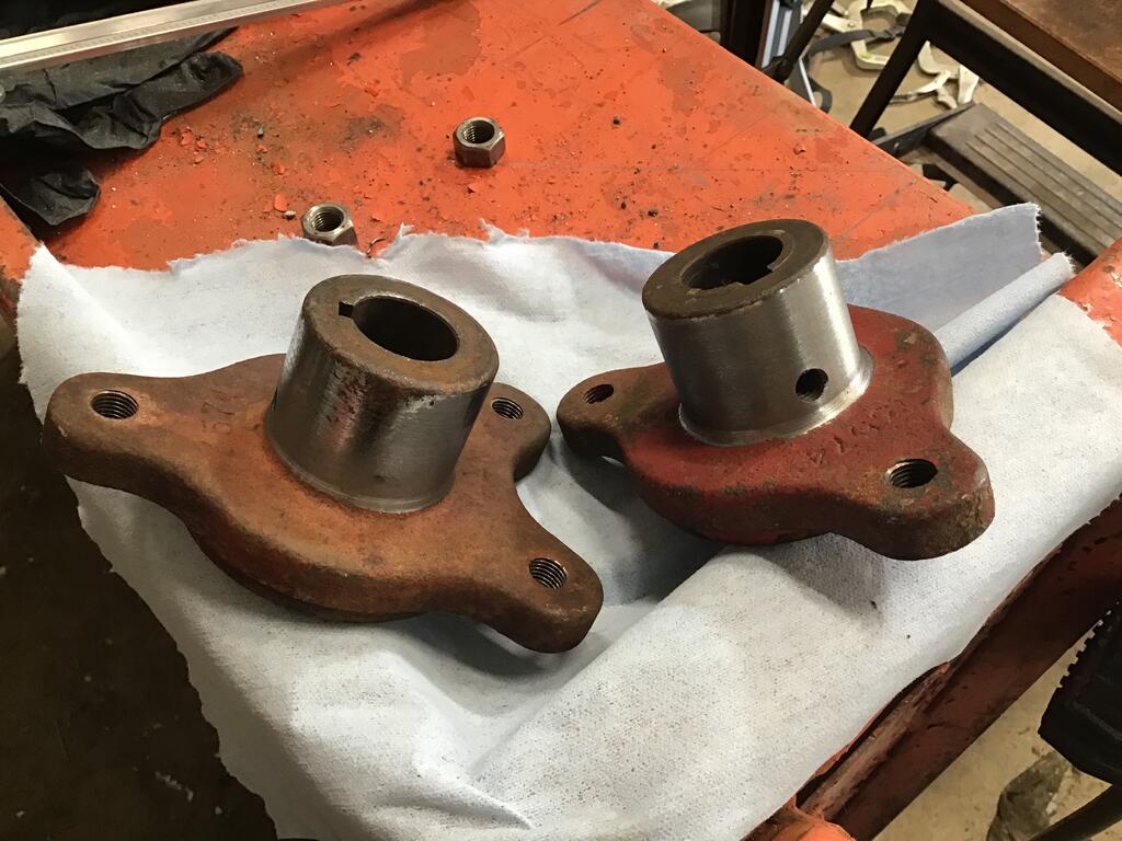

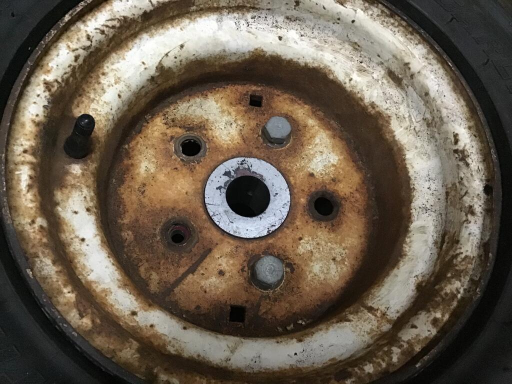

Pullstart 71,016 #70 Posted June 25, 2020 I made quite a bit of progress making front hubs today! Share this post Link to post Share on other sites

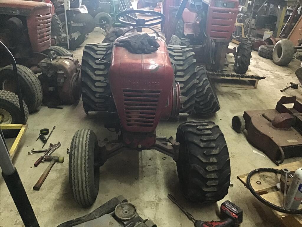

Pullstart 71,016 #71 Posted June 25, 2020 They even fit the wheels now! 1 Share this post Link to post Share on other sites

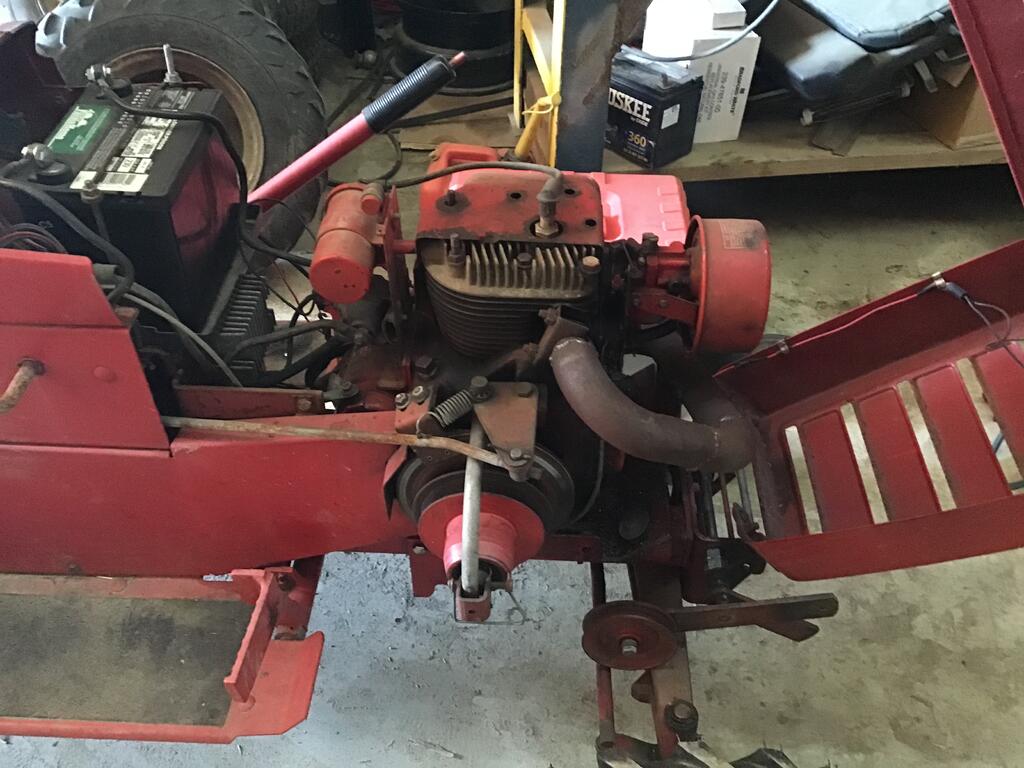

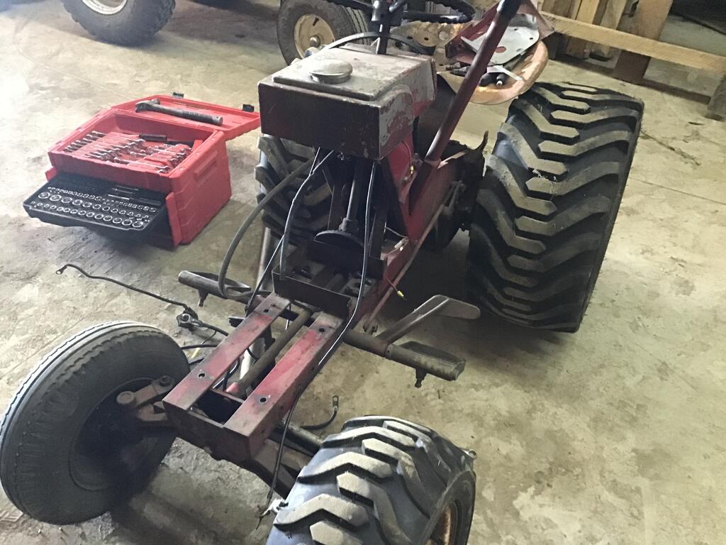

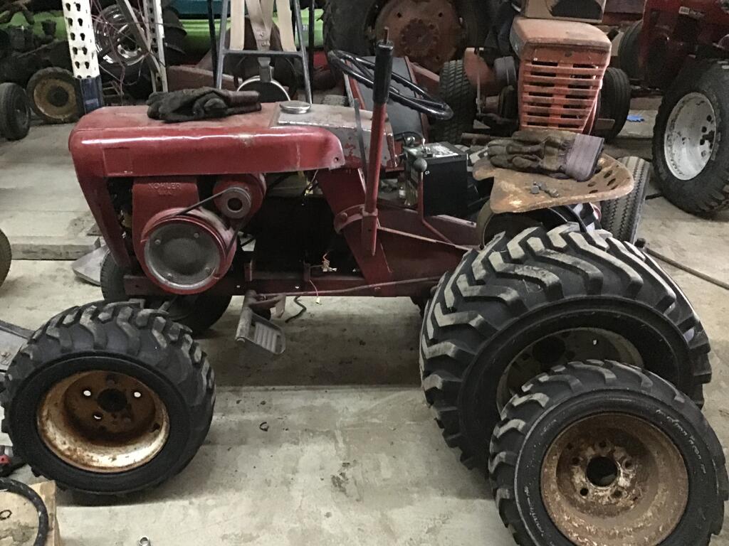

Pullstart 71,016 #73 Posted August 19, 2020 Well, everyone has their price indeed. This 701 engine is now Uncle Jim’s. Somehow we traded MY 701 stuff and MY kid’s slave labor and SHE got the tractor from Jim... I have plans to stick the engine from Steve the C-81 in this chassis. The battery will need to be relocated possibly under the seat, but it’ll be a fun chore tractor! 2 1 Share this post Link to post Share on other sites
Pullstart 71,016 #74 Posted August 19, 2020 These ‘60s tractors come apart so easy... the ‘70s ones.. a little more involved! 1 1 Share this post Link to post Share on other sites
Tractorhead 9,217 #75 Posted August 19, 2020 Tyres looks great. 👍 1 Share this post Link to post Share on other sites
