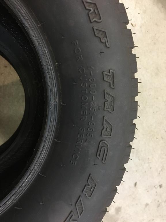

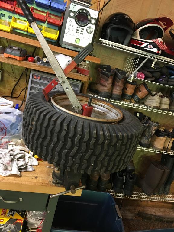

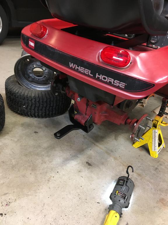

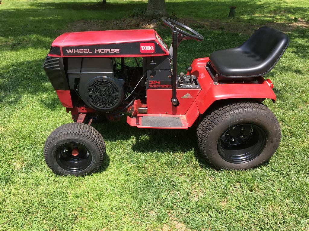

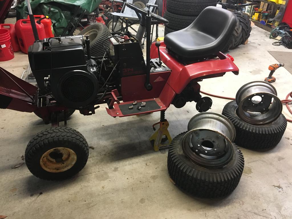

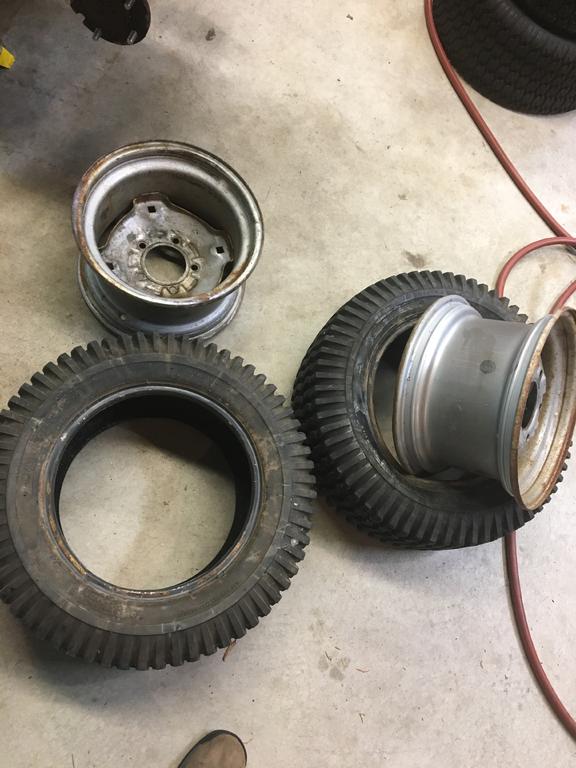

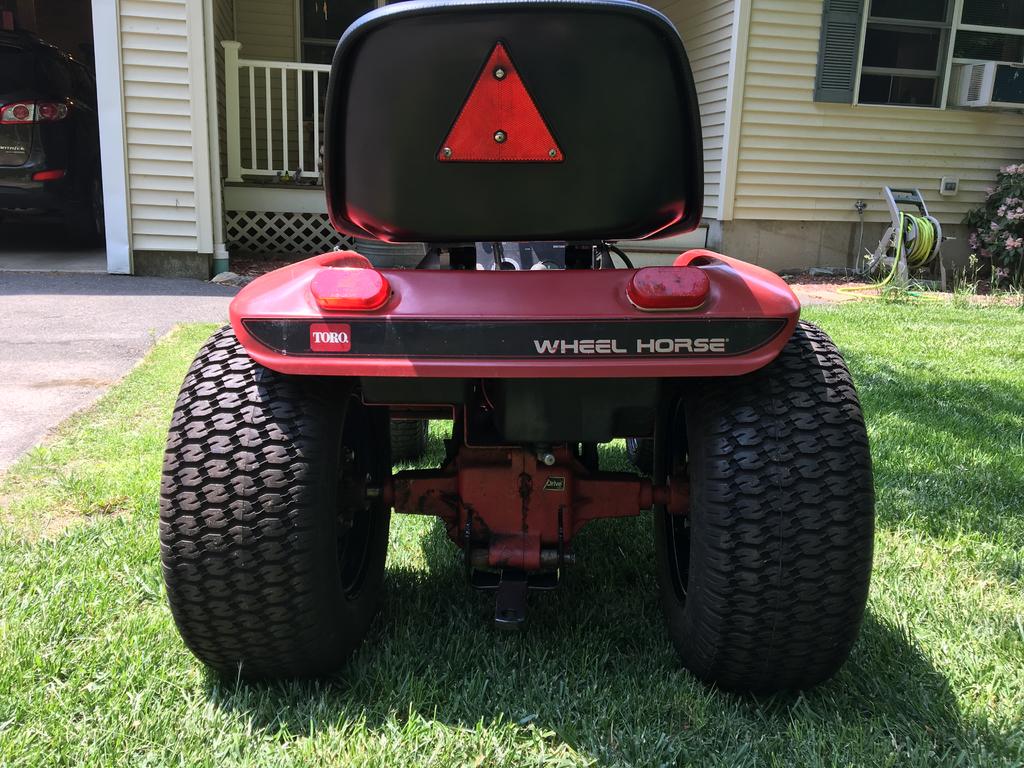

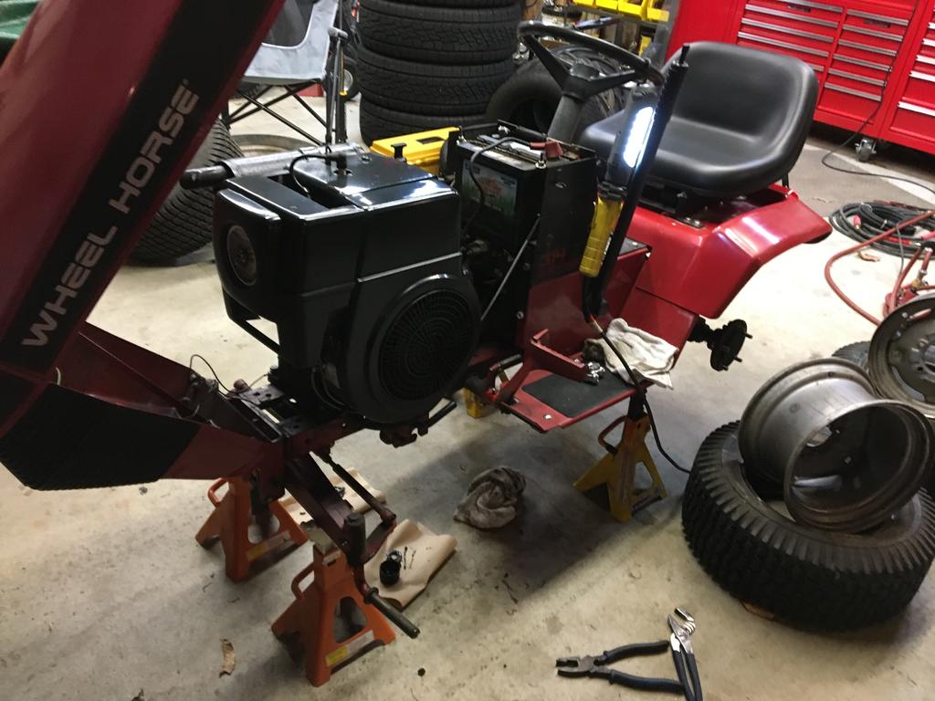

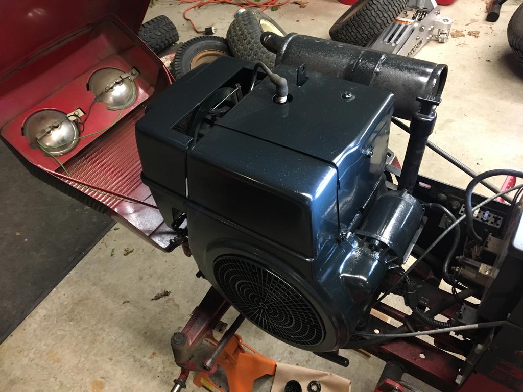

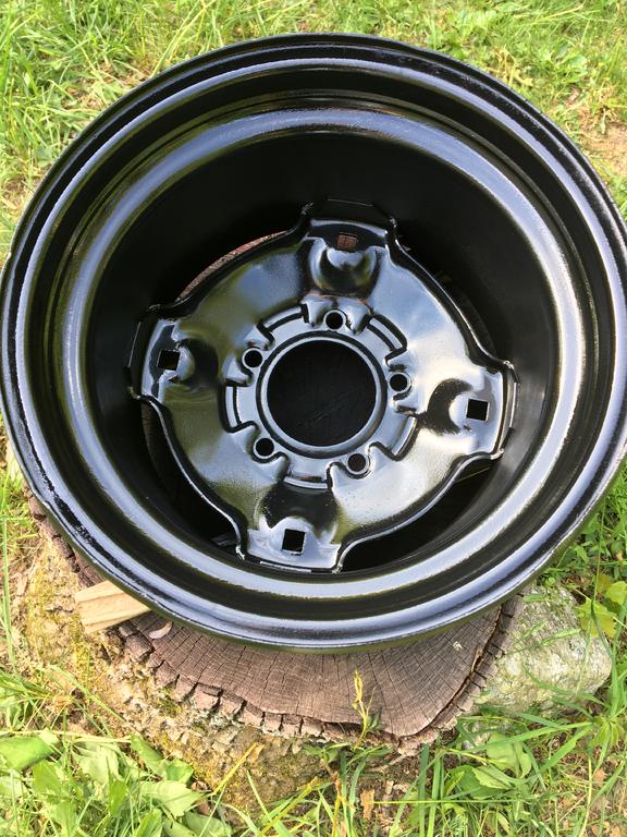

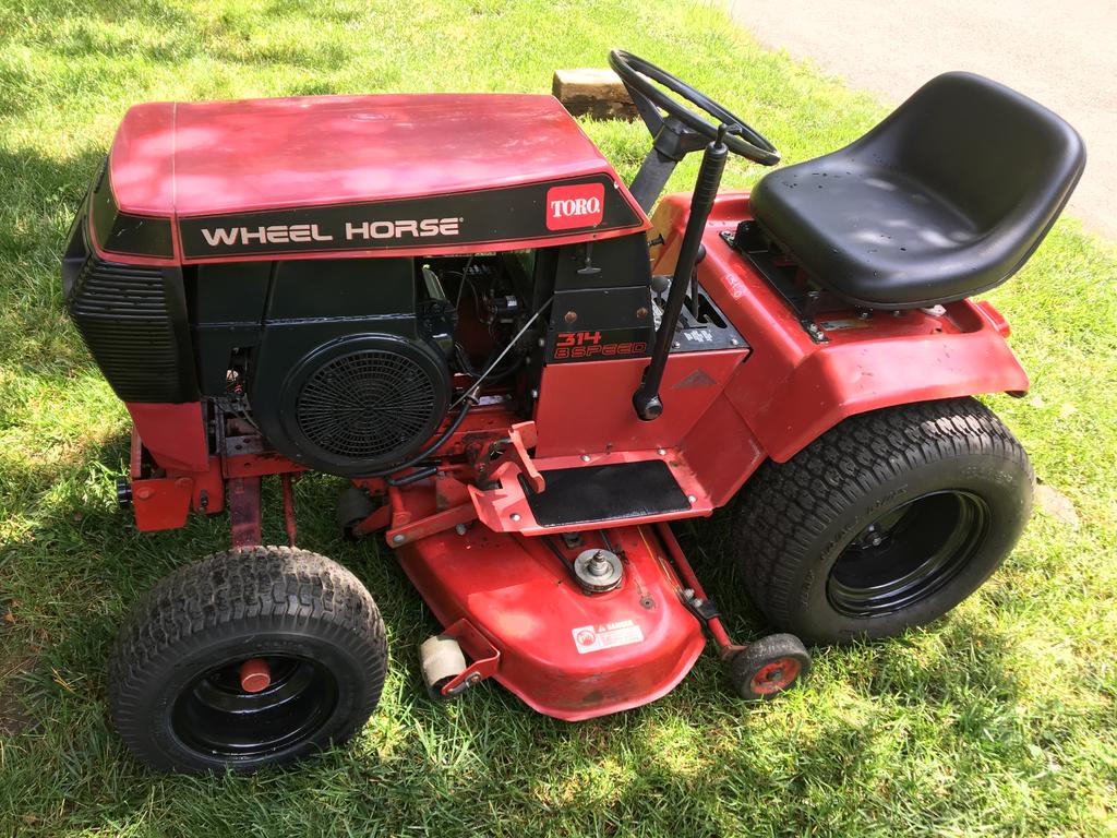

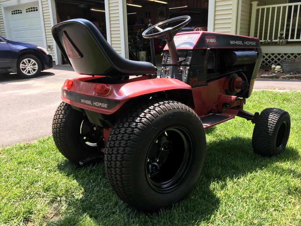

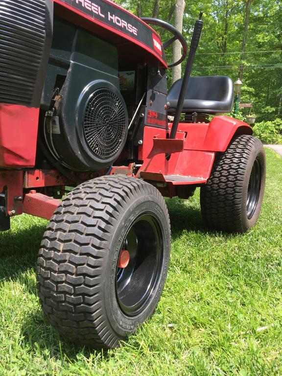

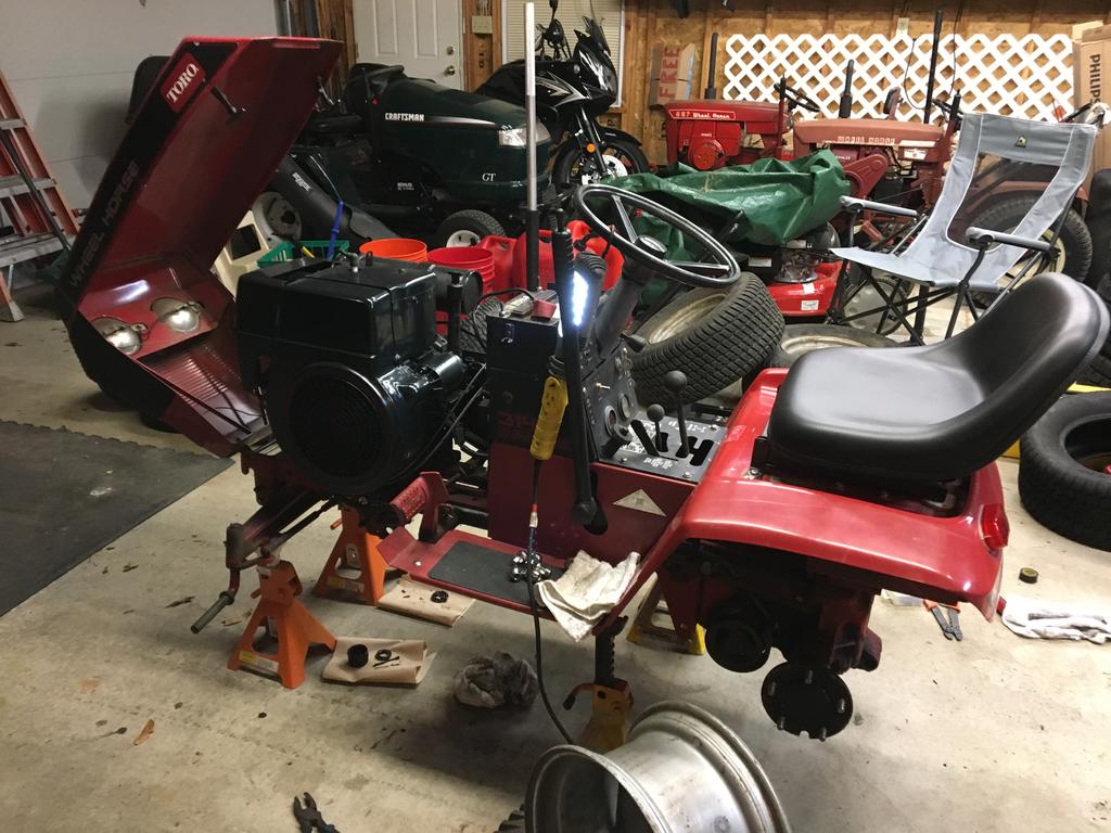

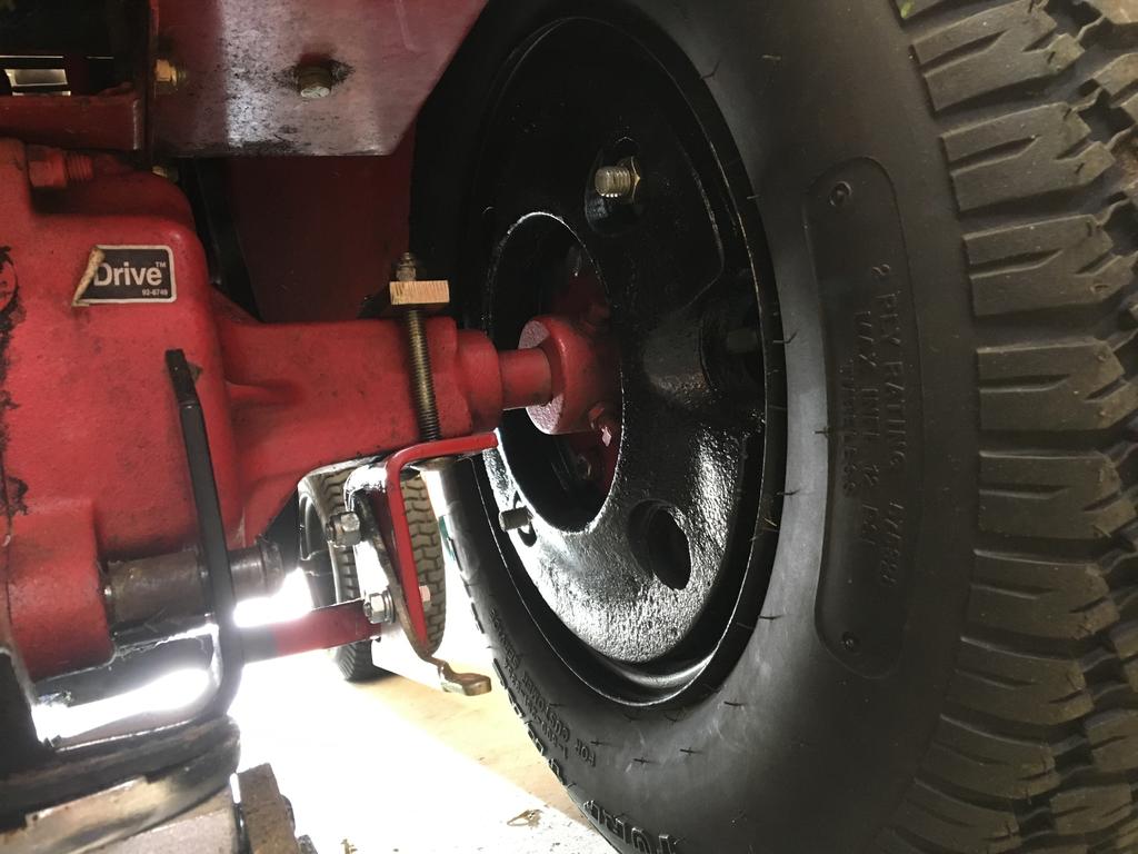

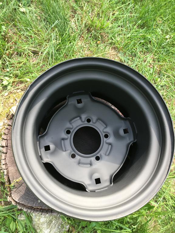

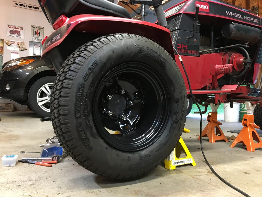

Sparky-(Admin) 26,693 #1 Posted June 2, 2019 My son and his fiancé are shopping for a house so what do I do??? Start shopping for a WH for them as a gift of course! Talking with Russ @SALTYWRIGHT I discover he has a 314-8 with a Magnum 10 under the hood....perfect ! We work out a deal and I bring it home. Mechanically it’s in good shape, gave it an oil change and lubed up any moving parts. Decided I didn’t like the 22/7.50/12 rear rubber so with my Harbor Freight tire changer I go to work...off with the old rubber, clean sand and wire wheel the silver rims, coat of black primer and two coats of semi-gloss black. I had two brand new Turf-Trac RS tires in a 23/9.50/12 size so mounted them up. The fronts are what came on a 70’s vintage machine and my neighbor took a fancy to those so I gave those to him. Meanwhile in my shed was a pair of 16/6.50/8 tires on the deep rims that just needed paint. So they get the same treatment as the rear rims received. With the same semi-gloss rattle can I repaint the front of the hood. Still need to mount the rear axle bracket and figure out what to do for a mowing deck. The tractor came with two 42” rear discharge decks but I’m thinking I would rather see a side discharge on it. This will be a surprise once they find a house, my son never goes on Red Square so he won’t see it posted here. Although once he owns this sucker I’ll make sure he signs up to be a Red Square member. He does attend almost all the Wheel Horse Collector Shows with me and will be at this years show as well. 11 12 Share this post Link to post Share on other sites

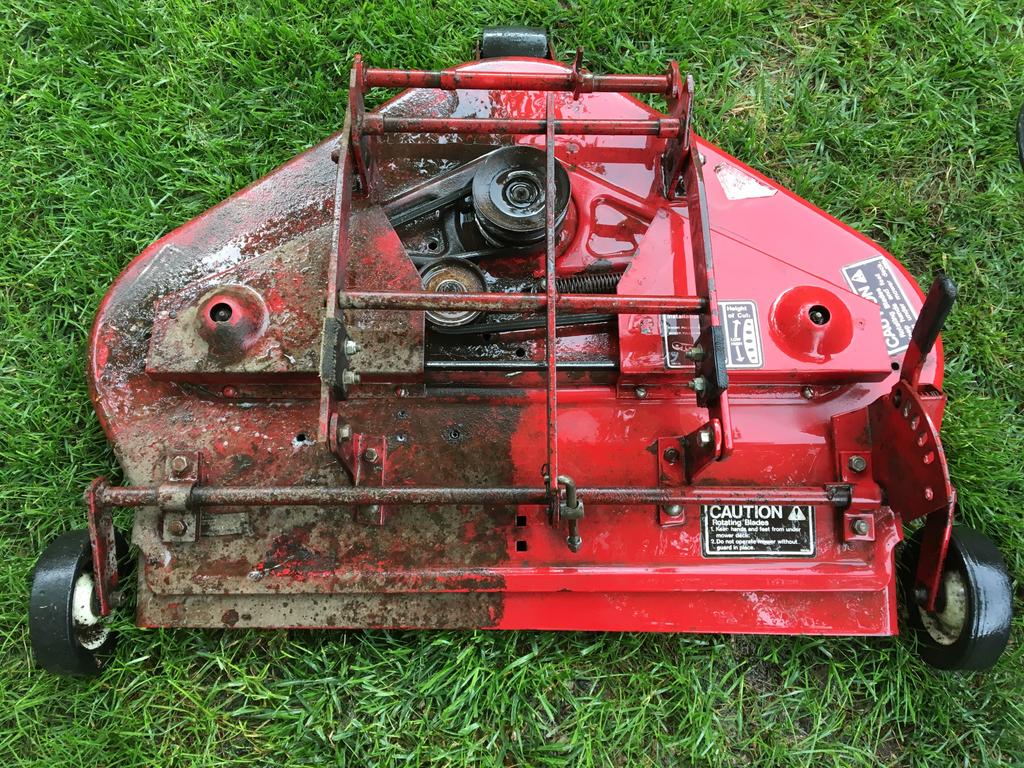

Sparky-(Admin) 26,693 #6 Posted June 2, 2019 So one of my 36” RD’s is pretty quiet so it’s the chosen deck for now. Can’t believe how grimy it has gotten sitting in my shed!! Half cleaned ! 4 1 Share this post Link to post Share on other sites

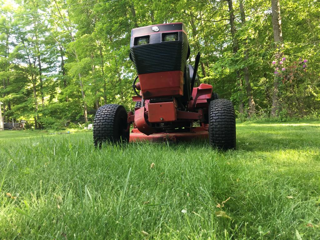

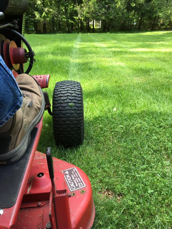

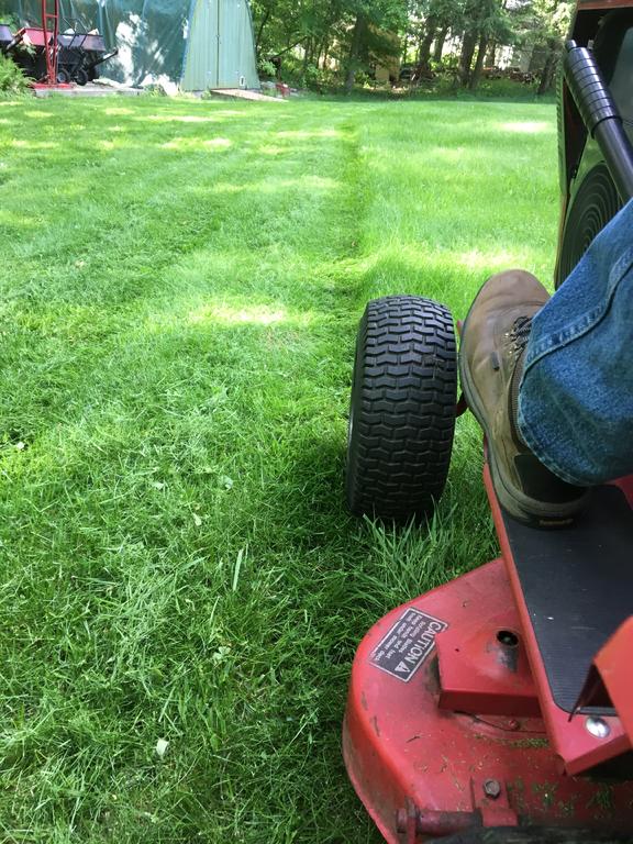

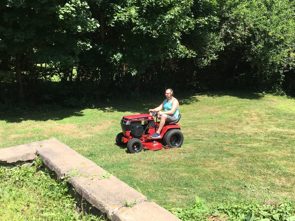

Sparky-(Admin) 26,693 #17 Posted June 3, 2019 Can’t hand off a machine without proper testing....so I mowed with it tonight ! Runs good, shifts good, PTO is good and the deck is fairly quiet. What I don’t like is the quality of cut from the little 36” RD. When I was cleaning the bottom yesterday the blades looked great. Maybe my grass was to long? 3 1 Share this post Link to post Share on other sites
Retired Wrencher 7,037 #18 Posted June 4, 2019 Looking good Mike. I am sure he will be happy with that. Good to have extra parts.I had my changer on a stump for years but now I do it like you with a vice. It works good. Share this post Link to post Share on other sites

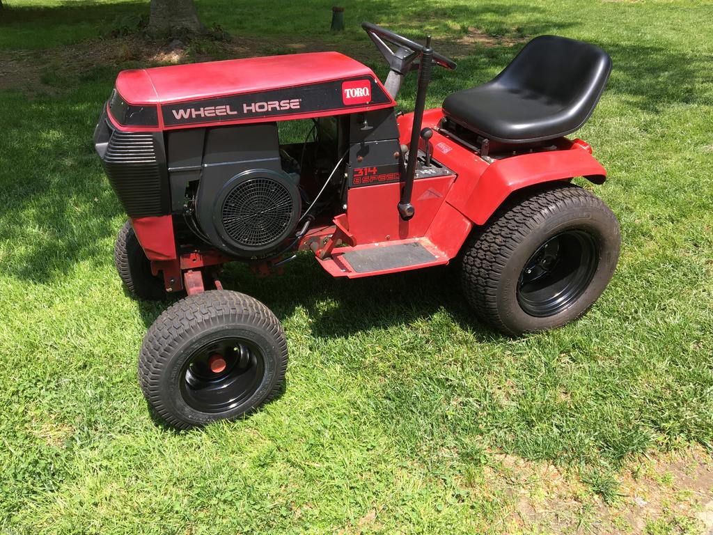

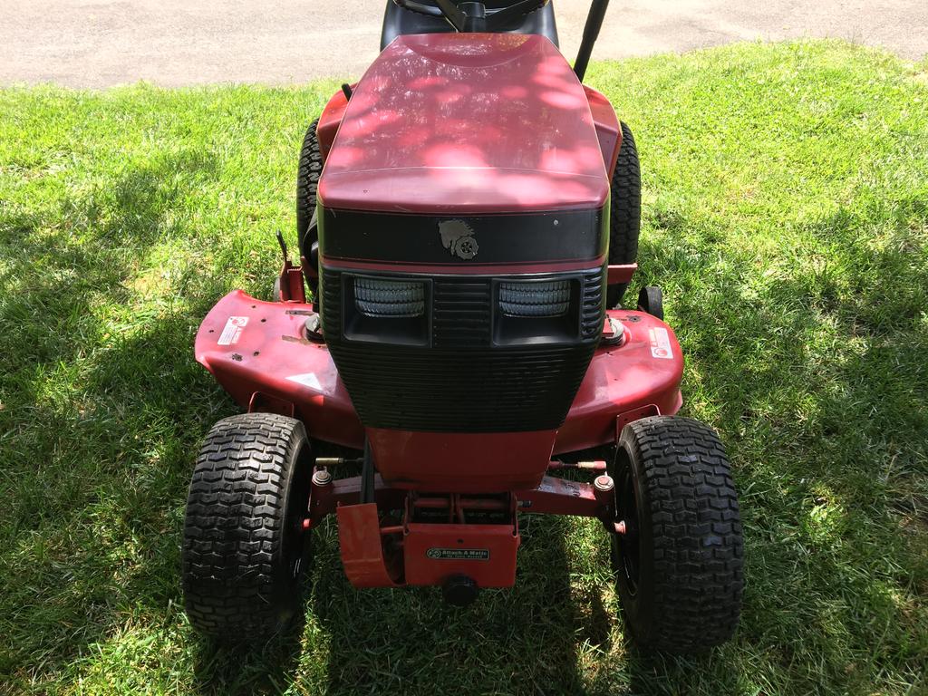

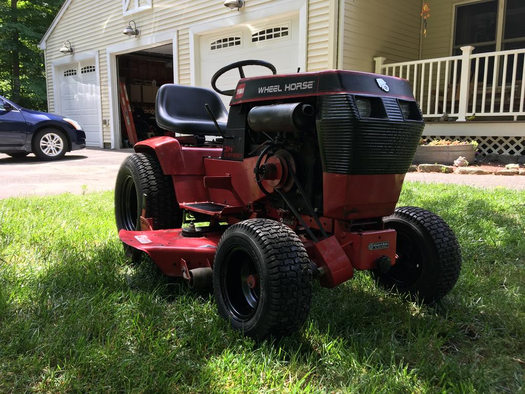

Sparky-(Admin) 26,693 #19 Posted July 8, 2019 So I wasn’t happy with the 36” RD I put on this gift tractor. Wanted a bigger deck and one a bit quieter that the 36. Scored a nice 42”SD , replaced both belts, all three blades, installed the NOS mule drive I snagged at this years WH Show, swapped the front spindles to the correct ones for 8” rims, put on a rear axle bracket in preparation for this winter, installed the inside wheel weights and gave her a bath. Just in time as the closing on their new house is the 24th of this month. This one is ready to be shipped out !! 4 3 1 Share this post Link to post Share on other sites

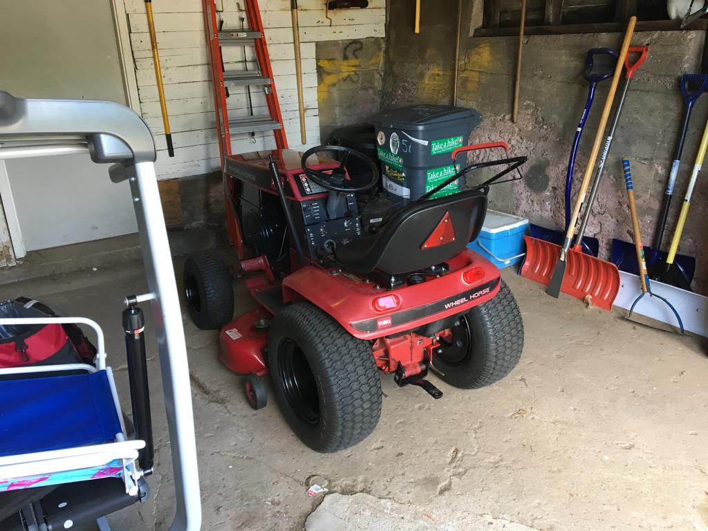

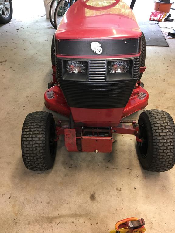

Sparky-(Admin) 26,693 #23 Posted August 12, 2019 DELIVERED! It’s now in his garage 6 3 Share this post Link to post Share on other sites
