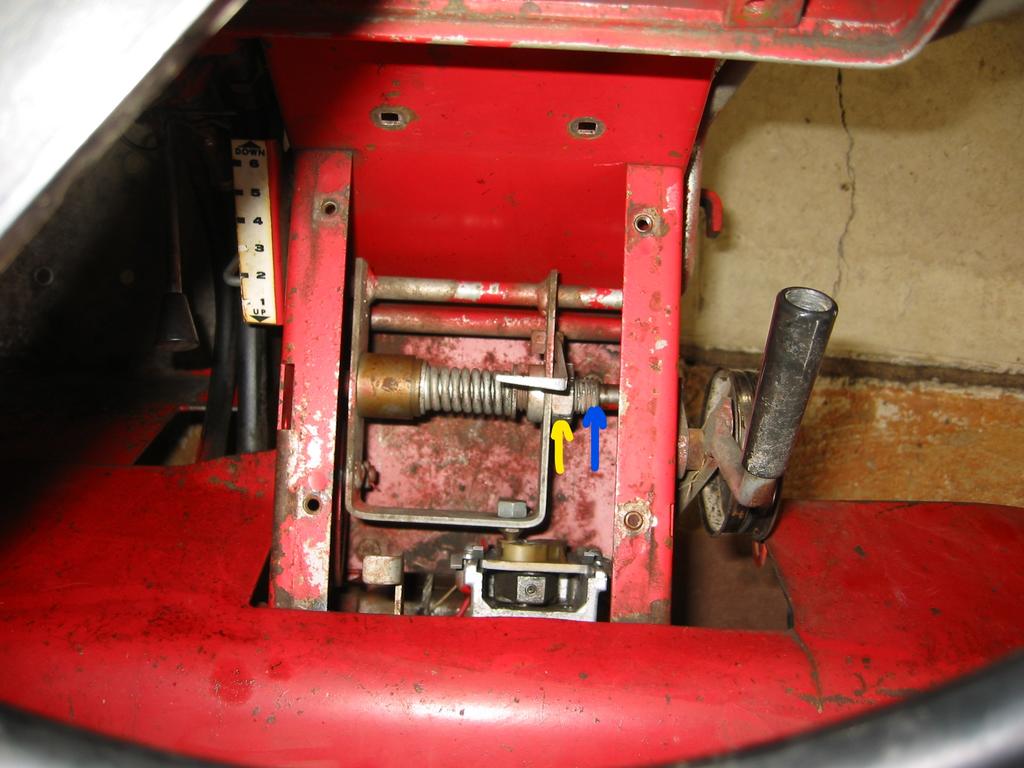

pfrederi 20,307 #3 Posted June 2, 2019 Loosen the lock nut (Yellow Arrow) 1-1/8". then tighten the threaded shaft (Blue arrow) it has 4 flat areas use a 5/8" wrench. Then re tighten lock nut. 1 1 Share this post Link to post Share on other sites
Platinum556 2 #4 Posted August 5, 2019 My 1966 1276 has the auto but the spring mechanism in the controls shown above are not on my model. My dads 67' 877 has the same problem. Im assuming they added the spring tensioning feature due to this problem. I cant seem to find one for sale or any other solutions to the problem. Any advice would be great 1 Share this post Link to post Share on other sites
Goofey 89 #5 Posted August 7, 2019 (edited) two springs to center it ? or something to rub up against? C-1something5 has a springy leafy thing to hold center and help hold set speed. Edited August 7, 2019 by Goofey Share this post Link to post Share on other sites
