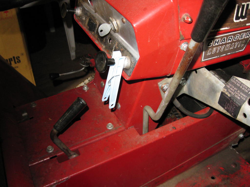

seven 202 #1 Posted June 1, 2019 It wants to keep slipping in is there anyway to fix it ? Share this post Link to post Share on other sites
wallfish 20,641 #2 Posted June 1, 2019 For the push pull type, the way I do it is cut off the Z bend and pull the wire out of the conduit. Put a slight bend in the wire to create friction between it and the conduit wall. Slide the wire back in and make a new Z bend. Just be careful because too much of a bend in the wire will create too much friction so test it before making the new Z bend. Or you can go the easy route and use clothes pins or small vice grips to clamp the rod near the knob 3 Share this post Link to post Share on other sites
pfrederi 21,197 #3 Posted June 1, 2019 John Beat me... One clothes pin fast idle two full throttle 4 Share this post Link to post Share on other sites
seven 202 #4 Posted June 2, 2019 Thanks Im trying the unhook and bend hopefully there enough cable left to bend new zz ? hook Share this post Link to post Share on other sites
wallfish 20,641 #5 Posted June 2, 2019 With the wire pulled out, you can cut the conduit a little shorter with wire cutters to expose more length of the wire end if needed. 1 Share this post Link to post Share on other sites
