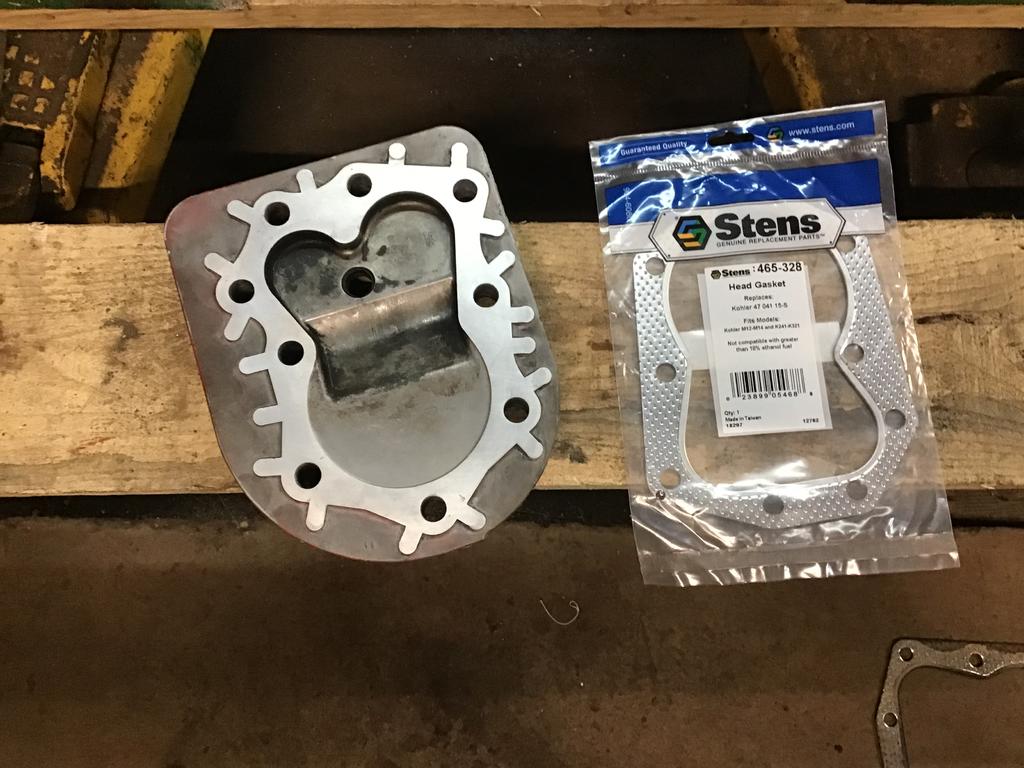

Pullstart 71,516 #1 Posted May 31, 2019 Frank smokes. I thought it started clearing up, but maybe I was imagining things. I had a spare head gasket, so tonight I pulled the head to inspect things. The crosshatch is gone, it’s a nice smooth glaze. With the slop you can see in the video, how long does this mill have before it lets loose? If I keep it topped off and take it easy, are we good for a few months of Puttin’ around? 1 1 Share this post Link to post Share on other sites
