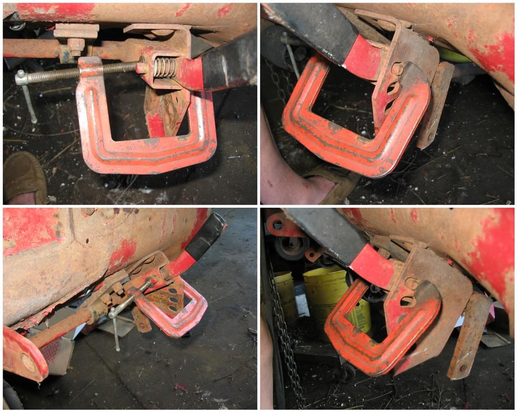

daveoman1966 3,884 #1 Posted May 28, 2019 (edited) Either on this forum or on FB, someone asked about the HEIGHT ADJUST LEVER not staying in the pre-set position(s). Tried to explain in words, but nearly impossible. So, here are a few pics of what I tried to explain using a C Clamp to solve the problem. Loosen (don't remove) the two quadrant bolts enough for it to slide sideways. With it loose, C clamp it to the Handle Spring-loaded Channel. While clamped, tighten the two quadrant bolts. Edited May 28, 2019 by daveoman1966 pics too big 2 2 Share this post Link to post Share on other sites
