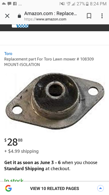

ericschevy2004 1 #1 Posted May 28, 2019 Has anyone ever had to replace the wheelhorse kohler k series engine isolaters and not wanted to fork out a small fortune for them? Found a repop, aftermarket or alternative? Toro 108309 MOUNT ISOLATION Share this post Link to post Share on other sites
oliver2-44 11,814 #2 Posted May 28, 2019 Click on this thread and it will show you a source for replacing them with solid mounts. There are also some threads on here (somewhere!) on replacing them with a combination of washers. Many have found the rubber mounts do not improve the tractors smoothness or actually reduce vibration. Thats probable why WH didn't use them for very many years. 1 1 Share this post Link to post Share on other sites
Ed Kennell 47,809 #3 Posted May 28, 2019 Replace the rubber mounts with solid spacers or washers. 2 Share this post Link to post Share on other sites

oliver2-44 11,814 #5 Posted May 28, 2019 This thread has a picture and dimensions to make your own solid steel engine mounts. You could possible use a stack of two sizes of washers to do the same thing. 2 Share this post Link to post Share on other sites
ericschevy2004 1 #6 Posted May 29, 2019 Thanks guys, I know I need to do something about it because it's been causing the tractor to blow about 2 belts a year. Of course the cost of the belts nearly offsets the price of the isolaters😂 Share this post Link to post Share on other sites
Ed Kennell 47,809 #7 Posted May 29, 2019 2 hours ago, ericschevy2004 said: it's been causing the tractor to blow about 2 belts a year. I believe the rocker plate design does not decrease vibration and it causes early belt failure. Allowing the engine to move causes a high frequency alternating load on the drive belt. Bolt it solid to the frame. 2 Share this post Link to post Share on other sites
