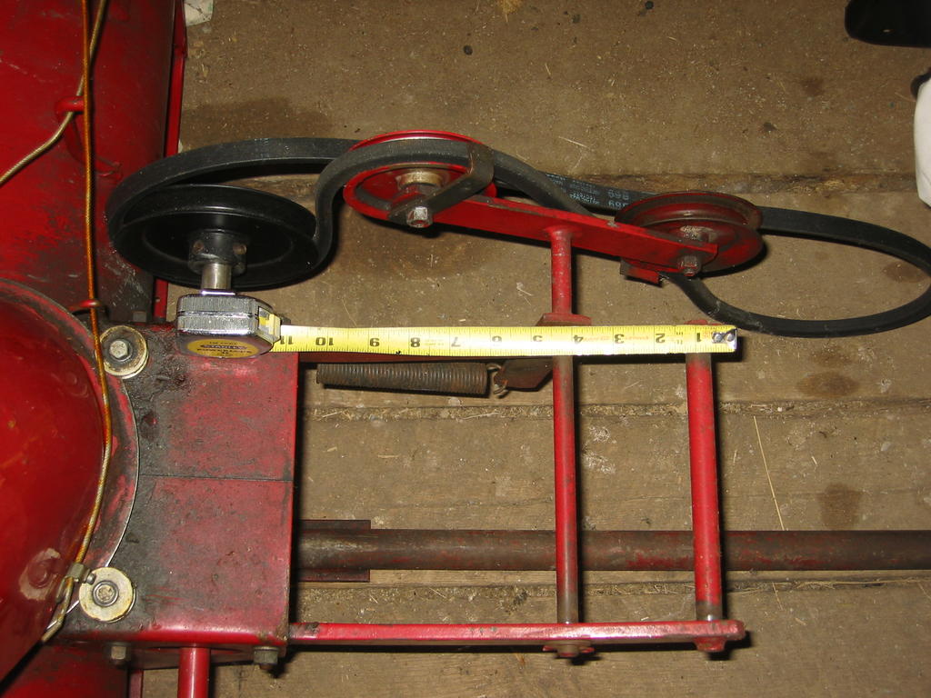

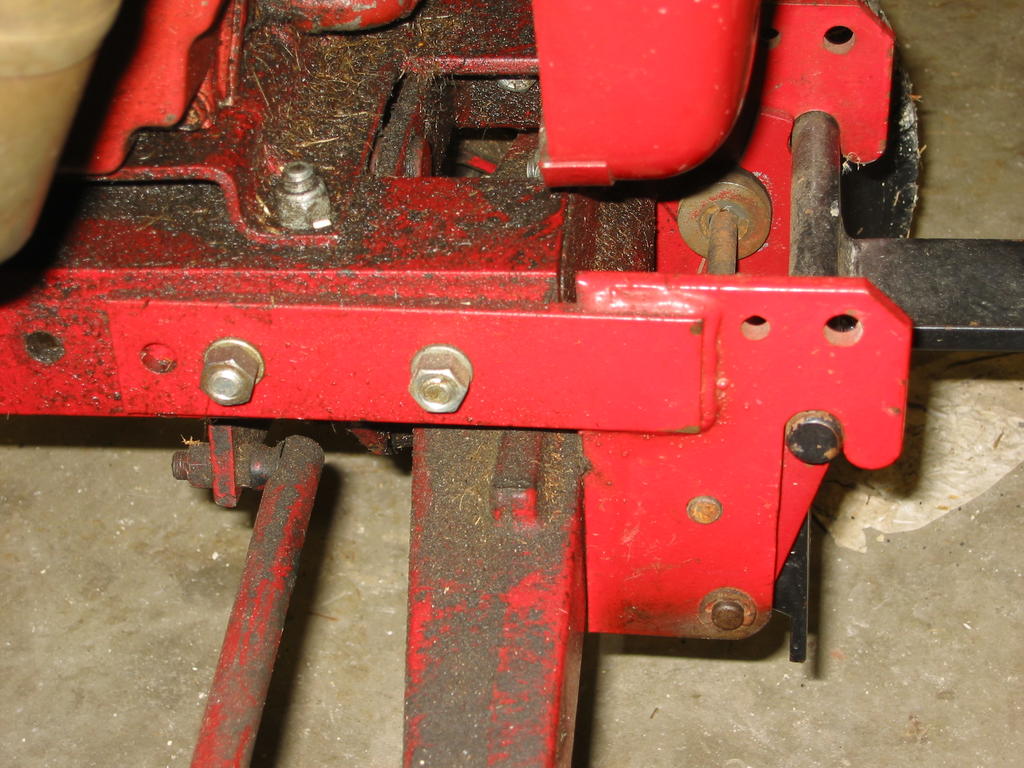

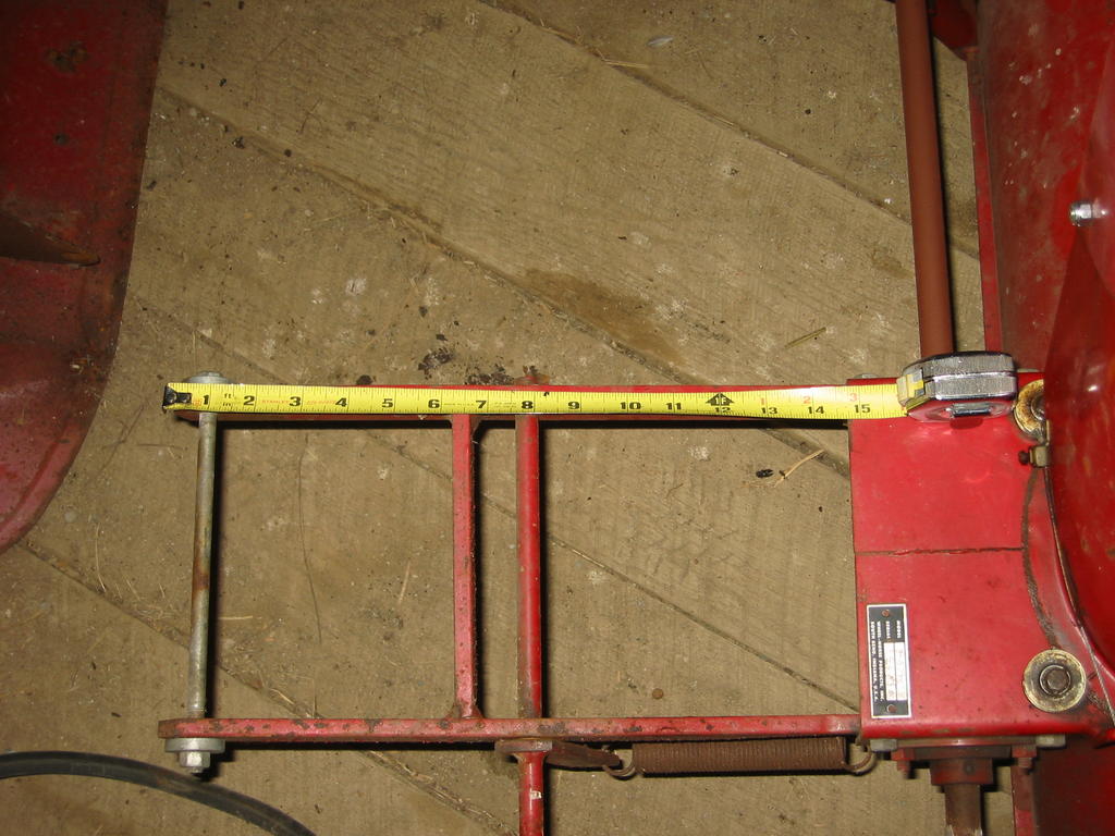

pfrederi 21,051 #6 Posted May 28, 2019 The only difference between the tow styles is the length of the mounting bracket. 1st pic is frame mount 2nd is tachmatic. You could swap out the brackets if you found one or you could pick up a pair of side plates last picture that let you use front tachmatic stuff ( Front hitch accessory 8-5551) 2 Share this post Link to post Share on other sites
