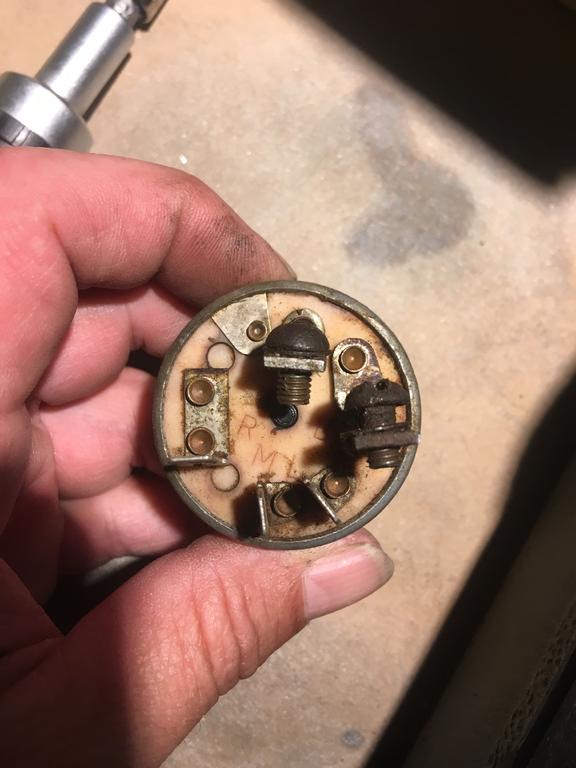

Darkitec 4 #7 Posted May 27, 2019 (edited) This is the factory switch that came on Grandfathers 1968 Raider 12 Magneto ignition. 4ga Power came from the battery to the switch and then from the switch directly to the starter. That's a lot of amps to run through a single switch for 50 years or so. Edited May 27, 2019 by Darkitec Share this post Link to post Share on other sites
953 nut 63,986 #8 Posted May 27, 2019 That is also a lot of potential for problems right behind your gas tank! You need to switch over to a battery ignition system anyway, why nod add a starter solenoid while you are at it? 1 Share this post Link to post Share on other sites
gwest_ca-(File Mod) 11,990 #9 Posted May 27, 2019 That switch was introduced in 1969 and was a retrofit for the 1968 models. Garry Share this post Link to post Share on other sites
