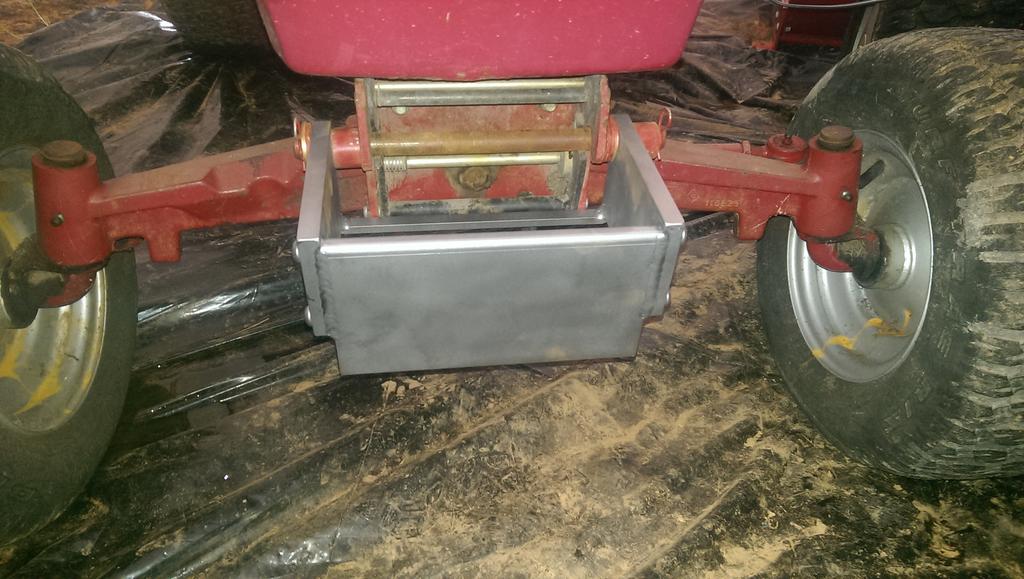

Achto 30,992 #3 Posted May 25, 2019 Adding a bumper should be very easy. You could just make bracket like I did for my front weights. Use the existing holes in the front of the frame for the bracket and add your bumper on to it. 1 Share this post Link to post Share on other sites

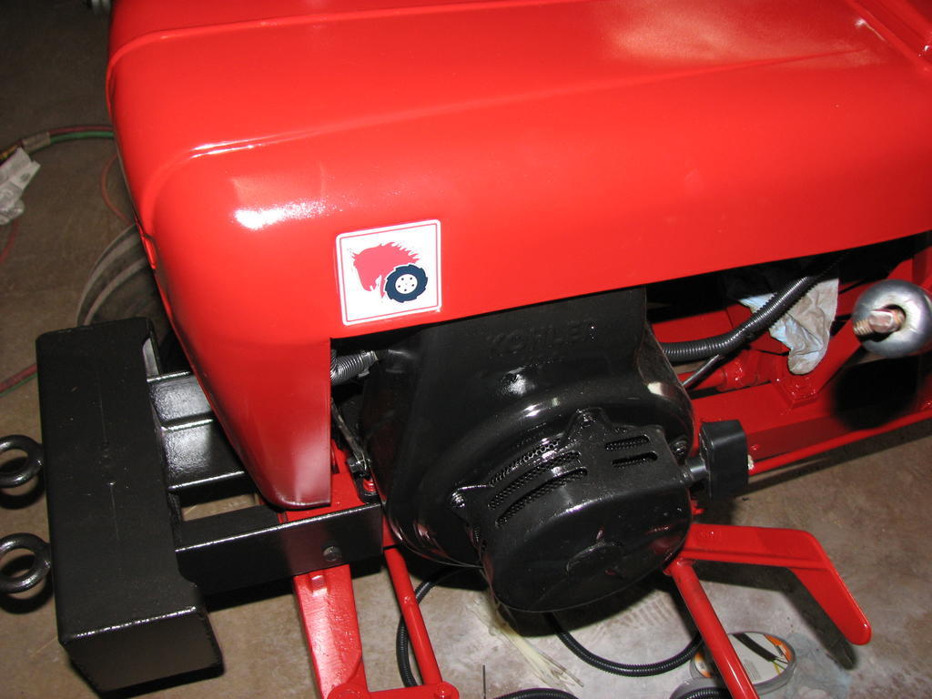

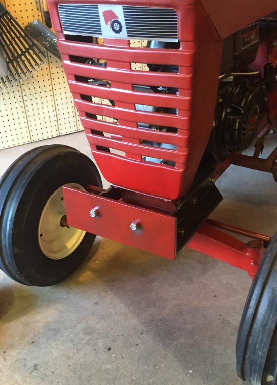

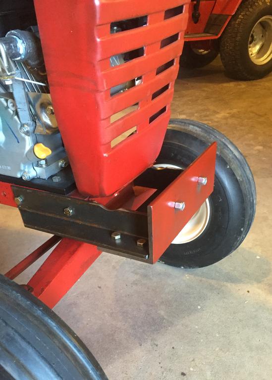

WVHillbilly520H 10,378 #4 Posted May 26, 2019 Bumper/weight hanger for the 3/4/500 series... 1 2 Share this post Link to post Share on other sites

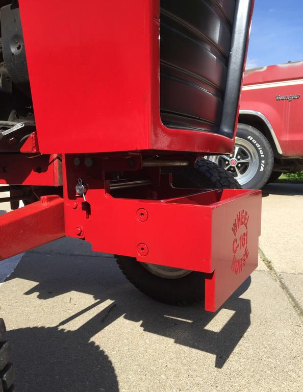

cschannuth 3,819 #5 Posted May 26, 2019 (edited) I have a couple of bolt ons that work well and one of those sweet weight hangers. Edited May 26, 2019 by cschannuth 2 4 Share this post Link to post Share on other sites

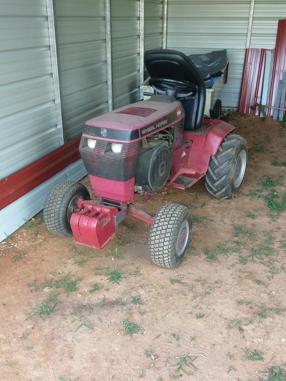

Lee1977 7,552 #6 Posted May 26, 2019 I spaced mine 1/2" away from the frame on each side to keep it from infering with the mule drive. 2 1 Share this post Link to post Share on other sites

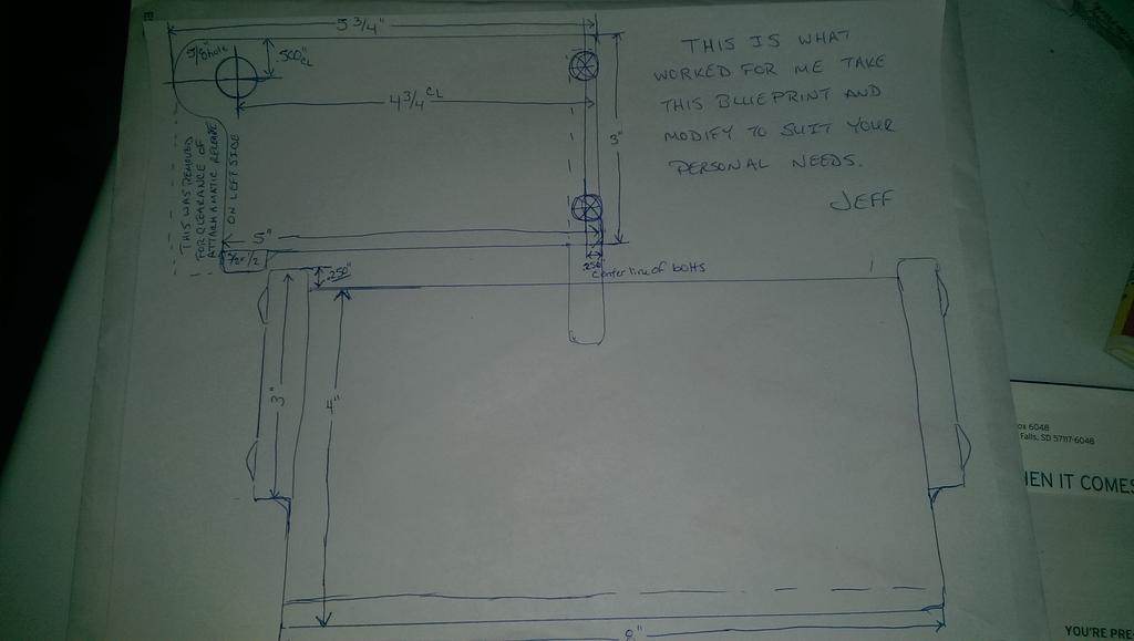

aSingularity 13 #7 Posted May 28, 2019 I found this thread and I think that i'm going to try to mimic this in the back. That will give me the base that I need to mount the toolbox also with a few modifications. @Lee1977 thats pretty much exactly what I was thinking, but using square stock and a small 1 inch reciever mount welded to it. 1 Share this post Link to post Share on other sites

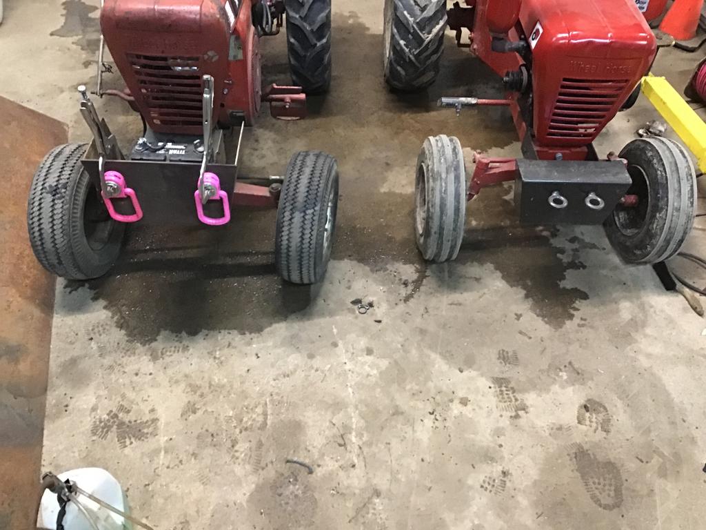

Pullstart 68,878 #8 Posted June 1, 2019 The hanging weight I built for Putt Putt has a cross brace that rests against the front of the frame, and two SBC exhaust manifold bolts simply press in place to hold it to the tractor. There wasn’t much room underneath to get a nut, or maybe I was testing to see how long it would work... but I can remove the whole weight by simply picking it up a bit and pull the bolts (pins) out of the holes. Share this post Link to post Share on other sites
Pullstart 68,878 #9 Posted June 1, 2019 Here’s a better picture... it helps explain what I couldn’t quite remember! The brackets are upside down angle iron, the horizontal pieces rest against the frame. The weight is cement filled. It’s not quite as heavy as cast iron, but Is still quite effective. Share this post Link to post Share on other sites
