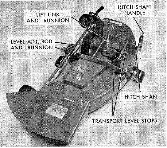

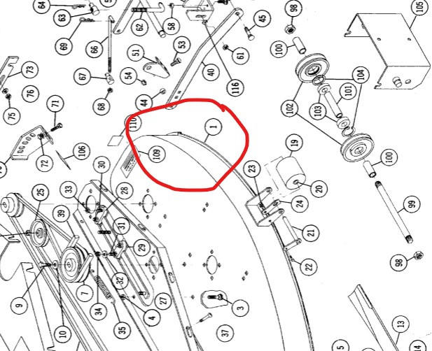

pgiro 38 #1 Posted May 24, 2019 Hello, I have D-160 with a 48" deck. The left side of the deck does not have a roller wheel like most other decks I've seen. As a result, it scalps the grass quite a bit when using it. From the document, it looks like it did not come will a roller on that side. I would like to add one but it's not a separate part # and would normally be part of the main deck assembly and be welded on. Does anyone know where I can get that bracket preferably with the roller wheel? Maybe someone has an old scrap deck and they can sell me that bracket? Don't know exactly what model deck I have, but see attached image for example of one without roller on left side and the other image is what I'd like to add. Thanks in advance for any help. Share this post Link to post Share on other sites
gwest_ca-(File Mod) 12,456 #2 Posted May 24, 2019 Your deck looks like model 5-1220. Click on the pictures. 1975 deck has a roller on the chute The 1976 deck shows the corner rollers Some later decks could also be used. Look through these https://www.wheelhorseforum.com/search/?&q="5-1221"&type=downloads_file&search_and_or=or&sortby=relevancy Garry Share this post Link to post Share on other sites
pgiro 38 #3 Posted May 25, 2019 Hi Gary, You're exactly right that it's a 5-1220 deck. Just checked the tag and it says "5-1220 9" The manual that I have for that doesn't show a roller on the side that I'm referring to as the left side (not the chute side) and the deck I have doesn't show any evidence that it ever had a roller there. Picture I just attached only shows a roller in the middle. Share this post Link to post Share on other sites
