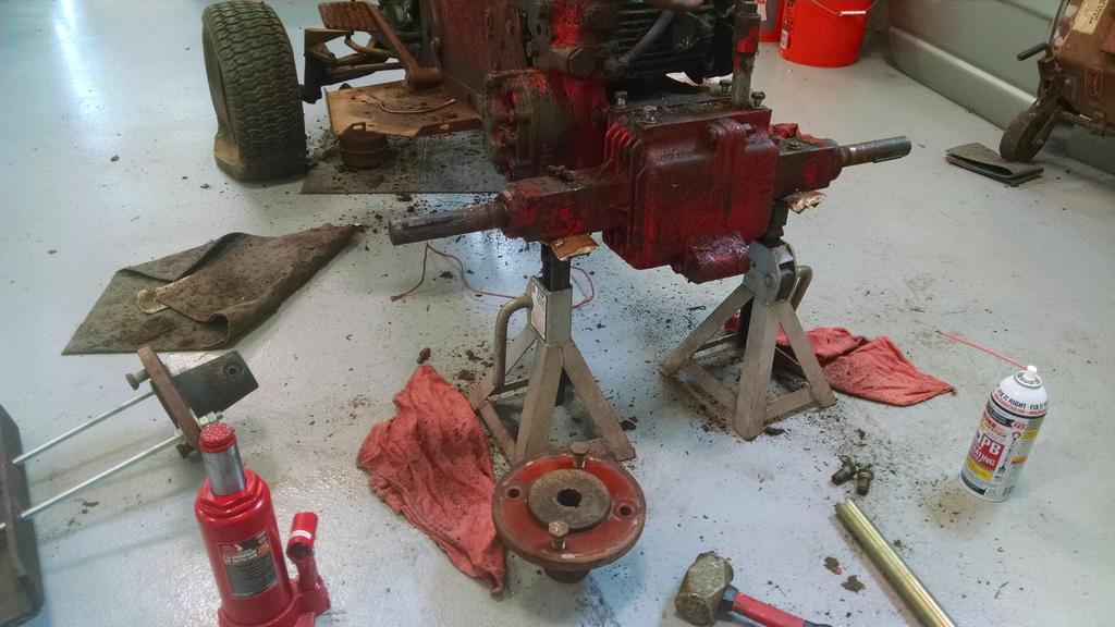

JAinVA 4,638 #1 Posted May 22, 2019 I needed to get the hubs off of Big Ugly to install new seals.This makes it painless. 5 9 Share this post Link to post Share on other sites

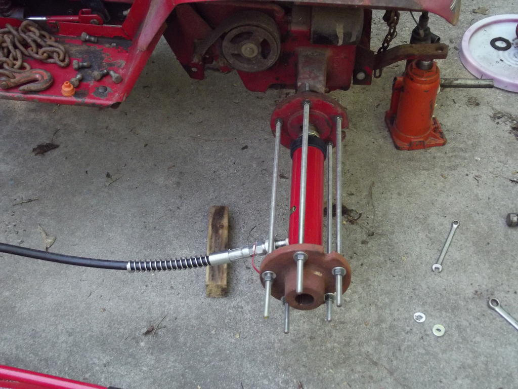

p38js 444 #3 Posted May 22, 2019 Here is the poor mans version, after a week with trying to get those darn things to budge, this contraption took about an hour and a lot of praying that no body parts would be harmed. 2 1 Share this post Link to post Share on other sites

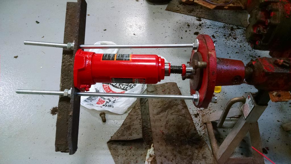

953 nut 69,827 #4 Posted May 23, 2019 Here is one that @meadowfield posted a while back. I liked it so much I made one too. 4 1 Share this post Link to post Share on other sites

Pullstart 71,372 #6 Posted May 23, 2019 Good ole’ porta-power! Share this post Link to post Share on other sites
Retired Wrencher 7,016 #7 Posted May 23, 2019 I just did mine. What a job. I had to use heat they where never maintained. But there off. The rest is easy for you. I used a little never-sees on the shafts I also put in new woodruff keys. 1 Share this post Link to post Share on other sites
Pollack Pete 2,273 #8 Posted May 23, 2019 Never thought of that one.And,I do happen to have a porta power.I guess I'm never too old to learn something new.Especially from other RS members. 2 Share this post Link to post Share on other sites
