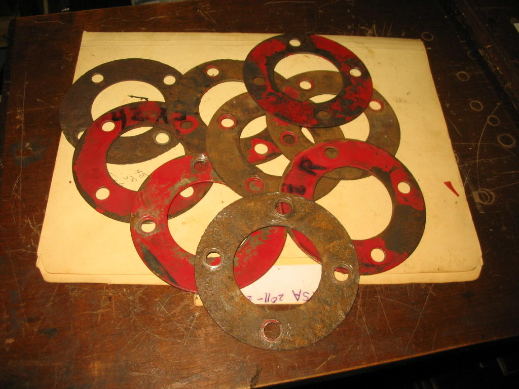

LFDRET 21 #1 Posted May 22, 2019 Does anybody know where I could find a set of reinforcement rings for my 42in rear discharge mower deck. I have cracking around my spindlels and I am trying to repair it. Share this post Link to post Share on other sites
daveoman1966 3,884 #2 Posted May 22, 2019 I have 2 or 3.... send me an email and I';ll reply with details...price and shipping. I am: daveoman@windstream.net Share this post Link to post Share on other sites

gwest_ca-(File Mod) 12,455 #4 Posted May 23, 2019 I believe the question was for something to reinforce the deck at the spindle assembly location. I am convinced the cause of the cracks in this area is from running blades that are not balanced. I don't know the dimensions of them or if these can be used for all spindles https://www.partstree.com/parts/toro/parts/106117/ Garry Share this post Link to post Share on other sites

daveoman1966 3,884 #6 Posted May 24, 2019 Jeeeze... $12 at Parts Tree... I'll send you THREE of them for $15.... plus $3 to ship in USA. Send payment to my Paypal or I'll accept a m.order ... Share this post Link to post Share on other sites
