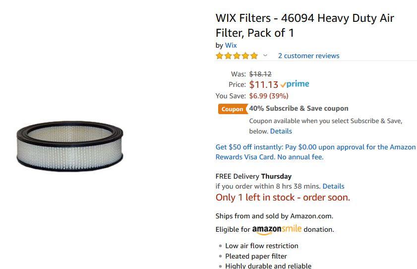

pfrederi 20,670 #10 Posted May 21, 2019 Nn10774 is Wix 46094 for a lot less$$$ Share this post Link to post Share on other sites
