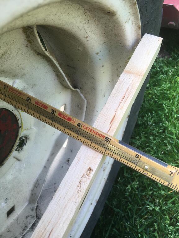

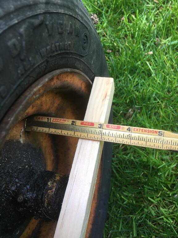

formariz 12,379 #26 Posted May 15, 2020 (edited) In your posts there are a couple of conflicts as to what tractor you are exactly interested in. Keep in mind that the RJ35 and the RJ58 are totally different tractors. Rear wheel offset for RJ 35 is 10.16cm. Front wheel offset is 5.08cm. If it is the RJ 35 you are trying to duplicate I will send you detailed photos of the frame. Use the dimensions I provide. Photos are a bit misleading since camera is at an angle. Edited May 15, 2020 by formariz Share this post Link to post Share on other sites

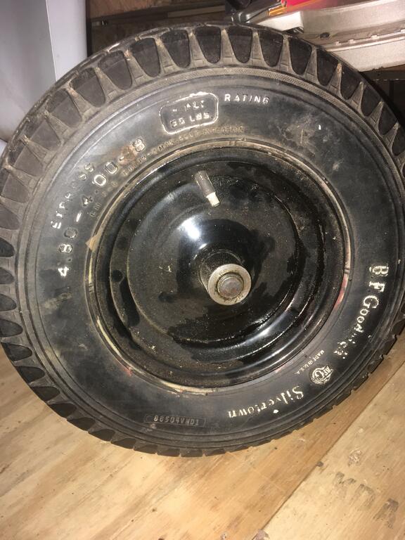

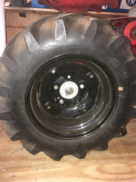

Jean of Normandy 1 #28 Posted May 18, 2020 Thanks for the wheel measurements how much are they in total height for the rear wheel (rim and tires)? yes c well the rj 35 and it is not its price it is the transport which is complicated and expensive. It is also a pleasure to try to reconstruct it. If I don't arrive then I will see how I can do it. Is there a differential on the Rj35? What is the diameter of the wheel axle or wheel hubs castin? thank you for your help and time for my questions. best regars Jean Normandy Share this post Link to post Share on other sites

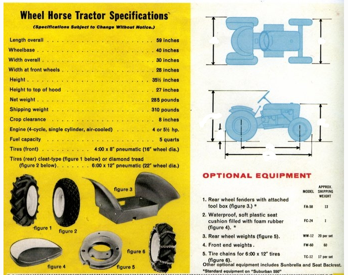

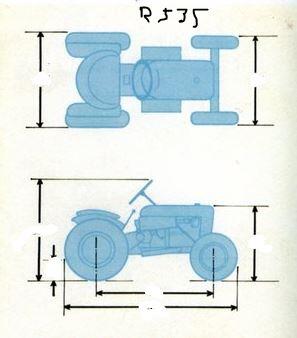

Jean of Normandy 1 #29 Posted May 18, 2020 sur le plan ci-joint c'est une banlieue mais ont-ils les mêmes mesures rj 58 et rj 35La Share this post Link to post Share on other sites
Jean of Normandy 1 #30 Posted May 21, 2020 Bonjour si vous pouvez m'aider s'il vous plait j'ai besoin de cette mesure Share this post Link to post Share on other sites

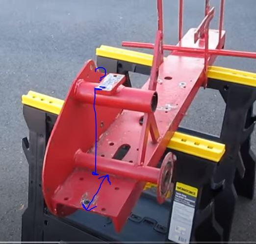

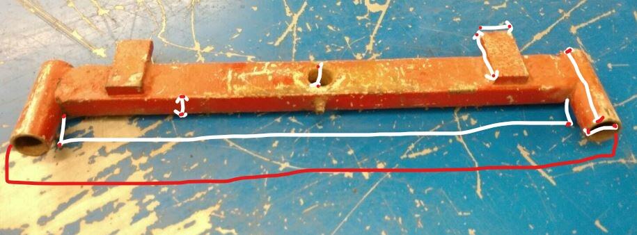

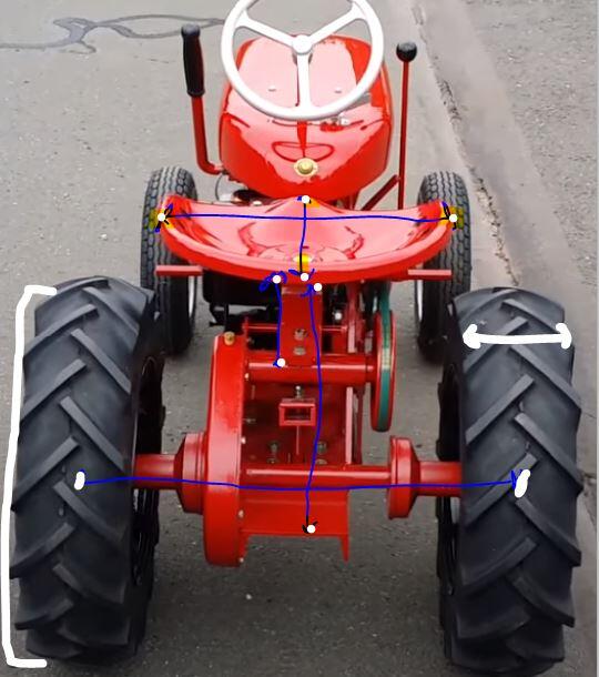

Jean of Normandy 1 #32 Posted June 1, 2020 Bonjour, je suis de nouveau désolé de vous avoir demandé à nouveau, mais veuillez prendre vos mesures. (photos jointes) pour RJ35 Et le diamètre et l'angle de la colonne de direction ainsi que le diamètre de l'essieu arrière et sa longueur totale Merci beaucoup pour votre aide cordialement jean de normandie Share this post Link to post Share on other sites
