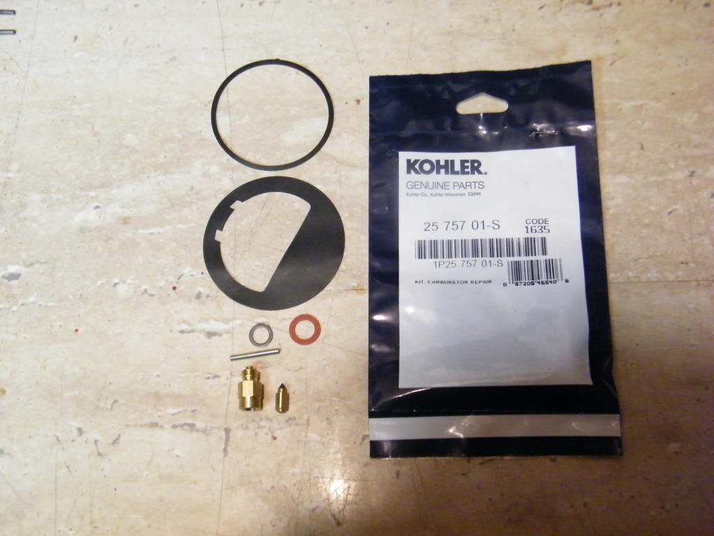

stevasaurus 23,705 #5 Posted May 19, 2019 I got this kit off E-Bay for my Carter "N" carb on my 857. Share this post Link to post Share on other sites
