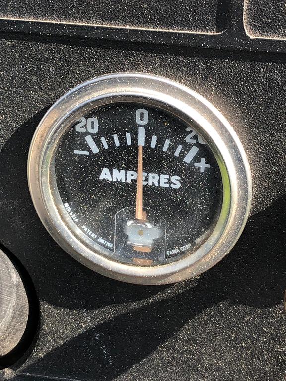

DaleLicht 6 #8 Posted May 19, 2019 I would guess I have an ammeter, since it says Amperes. Here is the picture. I will check the voltage at the coil. Share this post Link to post Share on other sites
953 nut 69,557 #9 Posted May 19, 2019 On 5/18/2019 at 10:39 AM, DaleLicht said: will be on zero and then jump up to 18 and then drop back to zero again That sounds a lot like a corroded ground at the Regulator/Rectifier. 1 1 Share this post Link to post Share on other sites

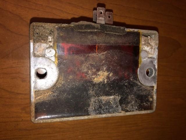

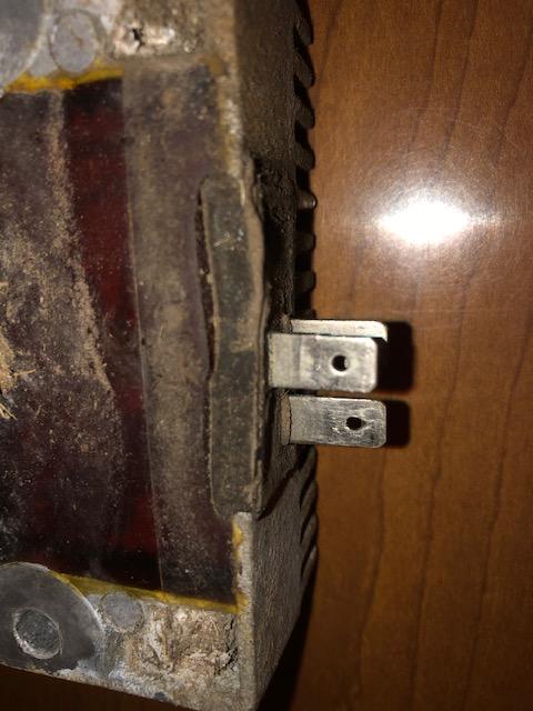

DaleLicht 6 #12 Posted May 20, 2019 So I removed the rectifier and found it to be in rough shape.See the pics. Where should I get the replacement? $180 bucks on the internet is pretty pricey. Share this post Link to post Share on other sites
bds1984 1,519 #13 Posted May 20, 2019 A generic 3-prong regulator with a 15-amp capacity will work just fine. I installed a generic unit on my C165 nearly five years ago and haven't had any issues to date. 1 Share this post Link to post Share on other sites
DaleLicht 6 #14 Posted May 20, 2019 I was able to find the exact replacement on Amazon for $30. The trick is to use the Kohler part number which is Kohler Part # 237335, and not the designated Toro Part # 101450. Hopefully this will fix the problem. Thank you 1 Share this post Link to post Share on other sites

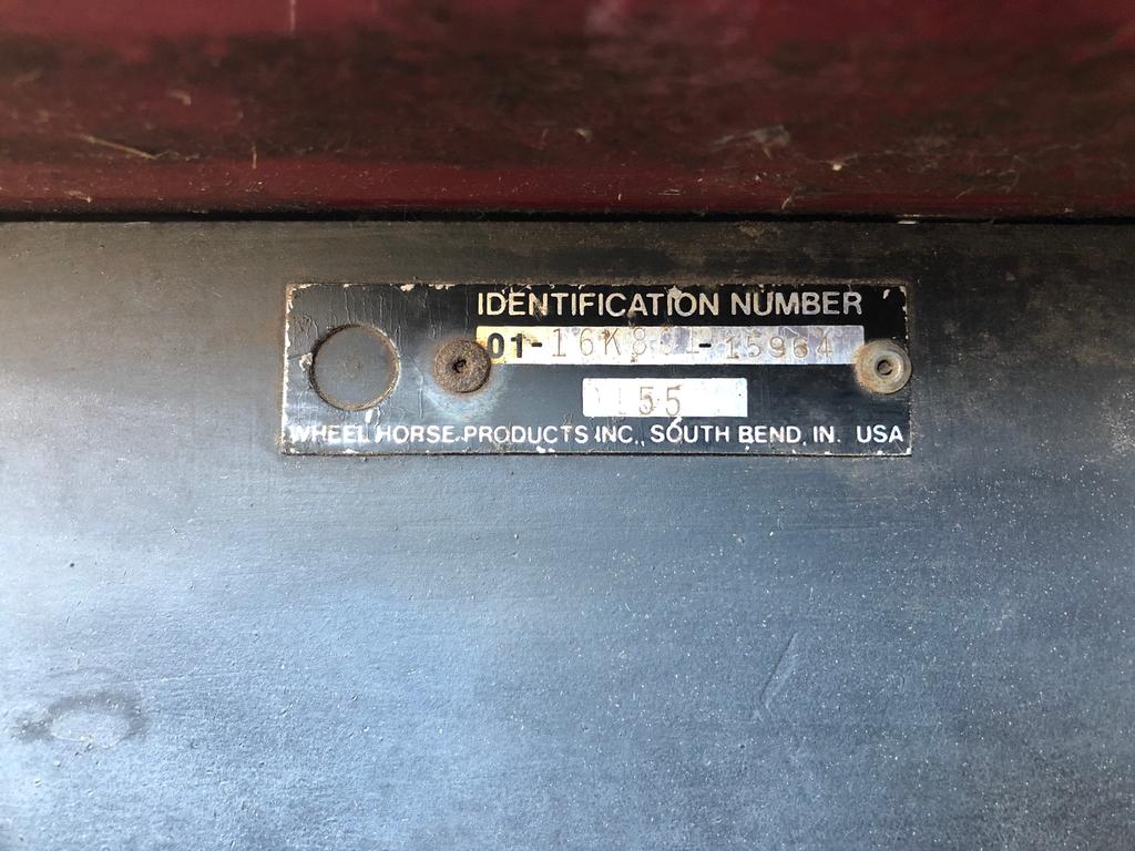

DaleLicht 6 #21 Posted May 24, 2019 Gary, The tractor ID # 01-16K801-15964 L55 I believe the year is 1980 not 1984 Ground was at the battery terminal for all volt measurements and John from VA suggests I run a separate ground for the motor. I can try that this weekend. Unfortunately I have to work, and ruin all my fun. Thanks! Share this post Link to post Share on other sites
gwest_ca-(File Mod) 12,489 #22 Posted May 24, 2019 That helps. I thought there was a possibility it was not a 1984. The build date L55 is 0155 Tuesday June 3, 1980. This is the 104680 pto switch. 1/2 of the switch controls the starter circuit and the other 1/2 controls the ignition. Click on the picture These diagrams will help Garry 1 Share this post Link to post Share on other sites
