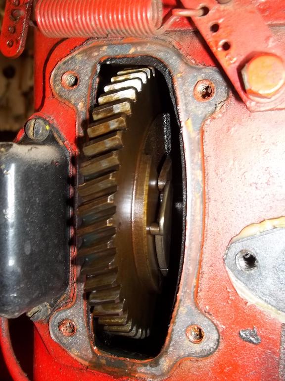

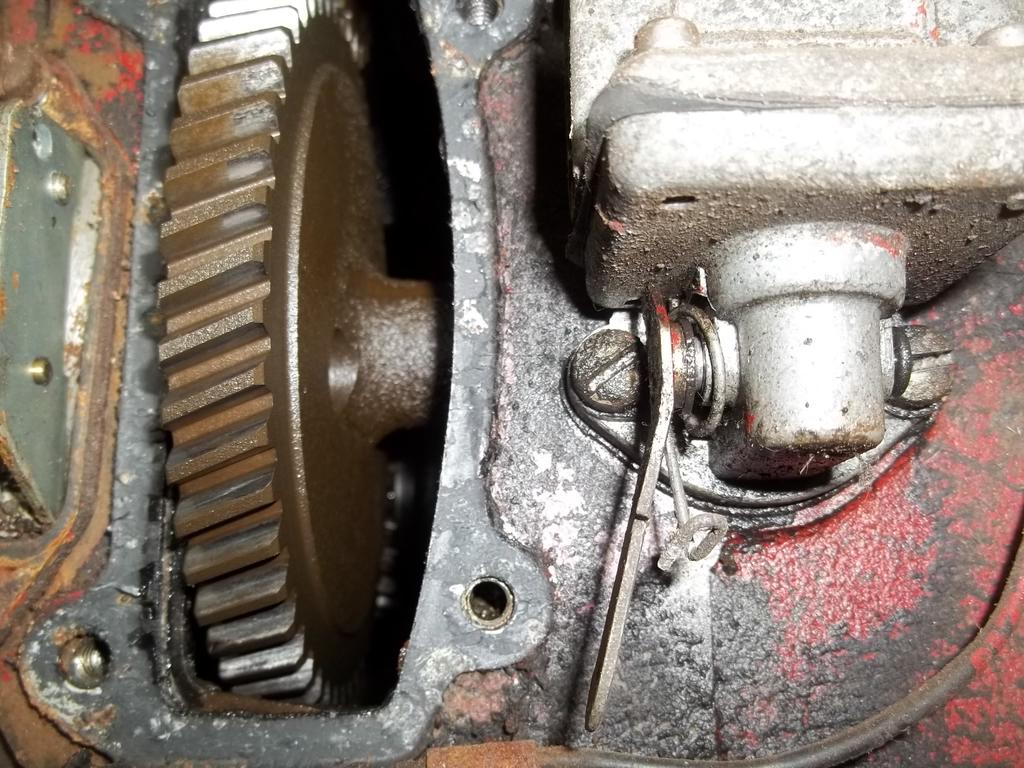

953 nut 67,562 #52 Posted May 23, 2019 On 5/20/2019 at 9:38 PM, WHX22 said: It has a cam that I have never seen with a spark retard on the side opposite where the ACR should be. Having the spark retard cam I wonder if the timing marks on the flywheel would have to be different than others to allow for Static Timing? Seems like the timing at rest would show up at or near TDC rather than advanced twenty degrees. 1 Share this post Link to post Share on other sites
WHX?? 57,472 #53 Posted May 23, 2019 16 minutes ago, 953 nut said: timing marks on the flywheel Would be easy check for me, during assembly I highlighted the stamps on the flywheel with white paint for easy looking. There were two marks. One for TDC and one for advance I'm guessing. I have one of those old skool things called a timing light I always wanted to try. 1 Share this post Link to post Share on other sites

953 nut 67,562 #55 Posted June 6, 2019 (edited) On 5/23/2019 at 2:31 PM, 953 nut said: Having the spark retard cam I wonder if the timing marks on the flywheel would have to be different than others to allow for Static Timing? Seems like the timing at rest would show up at or near TDC rather than advanced twenty degrees. I just had to know! I had great results with static timing on one of my 953s which has Spec suffix "A" and couldn't quite wrap my head around the idea the it would work with a spark advance cam. Took a look inside and found that it has an ACR cam. Out of curiosity I checked it with a Timing Light and it was dead on. One of the others I have has the spark advance cam, so I think it wouldn't be a candidate for static timing. One of these days I may give it a try and see what the results are, let you know when that happens. Edited June 6, 2019 by 953 nut 1 2 Share this post Link to post Share on other sites
