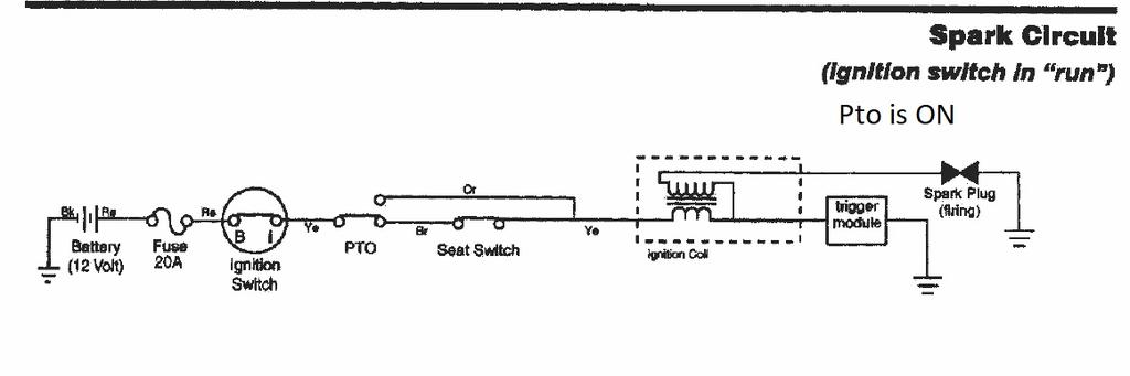

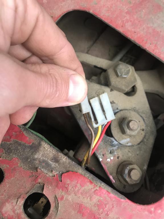

Walhonding520 25 #7 Posted May 14, 2019 It ran for about 30 minutes until it just shut off. After it sat for about another 30 it fired right up with a little more oil added. Got on to start mowing and it shutoff when I engaged the pto. Going to change oil tonight along with filter. Probably pull the seat switch wiring too just to make sure my jumper wire isn’t going bad. Just to verify again, I should be going yellow to brown in the picture correct? Share this post Link to post Share on other sites
Walhonding520 25 #8 Posted May 14, 2019 It ran for about 30 minutes until it just shut off. After it sat for about another 30 it fired right up with a little more oil added. Got on to start mowing and it shutoff when I engaged the pto. Going to change oil tonight along with filter. Probably pull the seat switch wiring too just to make sure my jumper wire isn’t going bad. Just to verify again, I should be going yellow to brown in the picture correct? Share this post Link to post Share on other sites
gwest_ca-(File Mod) 10,478 #9 Posted May 14, 2019 Yes - yellow and brown. The red wire goes to the dash light module. Garry Share this post Link to post Share on other sites
Walhonding520 25 #10 Posted May 14, 2019 So I messed with the pto switch a little with the tractor running. I pushed in the little black "button" that the pto lever triggers when engaged and the tractor would start to die. Kept pushing it a few times until it no longer killed the tractor. I am assuming that there is an issue with the switch then? Is there a way to bypass the pto switch (just for testing purposes) and if so, which color wires to I need to jump? I have the wiring detail above available now but I am far from an electrical expert. Share this post Link to post Share on other sites

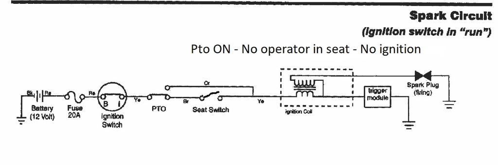

gwest_ca-(File Mod) 10,478 #11 Posted May 15, 2019 With the operator in the seat the seat switch should power the ignition when the pto is ON. At this time the yellow and brown are connected at the pto switch. With no operator in the seat the pto switch powers the ignition only when the pto is OFF. At this time the yellow and orange are connected at the pto switch. First two illustrations show operator in seat so seat switches are closed. Garry Share this post Link to post Share on other sites
