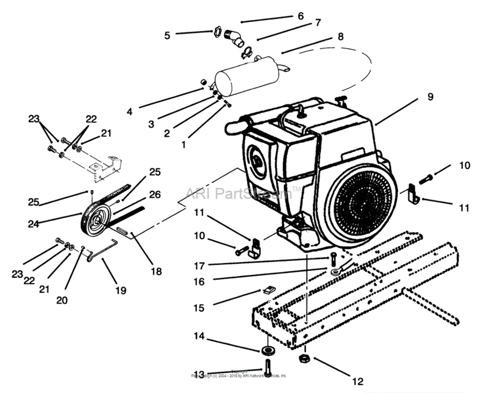

daveoman1966 3,884 #5 Posted May 14, 2019 At the engine pulley, there is a BELT GUIDE that keeps the belt from jumping off of the pulley. Dealer MAY have taken this guide off to replace the belt, and didn't put it back on. It is # 19 in this schematic. Secondly...the OEM belt should be # 108501 which is TORO 81 x 5/8" or WHEELHORSE 81.5 x 5/8". If an aftermarket belt is installed, that alone MAY be the problem. 2 Share this post Link to post Share on other sites
