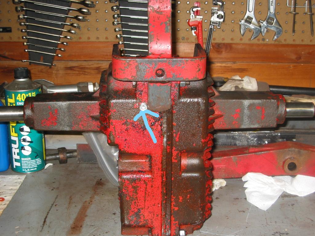

ebinmaine 81,046 #2 Posted May 13, 2019 Answer to question number one. A little extra fluid in there certainly wouldn't hurt anything but it's not necessary. Answer to question number two. Stick with what is in there right now. If you have 90 w in there right now then put that back in. You will probably find 85w 140 or 80w 90. I use 80w 90. Answer to question number three. Nothing secures that boot except for friction. The other thing that comes to mind right away is that when you are draining the transmission be sure to use the plug that is on the very bottom of the transmission. Lots of us, including me, don't find that right away. Also, while draining you will want to raise the front as much as you can do so safely. There is a bump in the middle of the bottom of the inside of that transmission that holds a lot of fluid in the front half. If that tractor runs and drives okay you may want to pick up a couple of quarts of diesel or kerosene and use that as a drive around flush fluid in between Putting all fluid out and new fluid in. Helps to clean up the gears quite a bit. Share this post Link to post Share on other sites

71_Bronco 1,073 #5 Posted May 13, 2019 Thanks so much guys! I saw the 2 plugs in the manual, but haven't actually climbed under it yet to find them. I'll update when I drain and see if anything is needed. Thanks! 2 Share this post Link to post Share on other sites

pfrederi 21,274 #7 Posted May 14, 2019 On 5/13/2019 at 7:16 AM, 71_Bronco said: Thanks so much guys! I saw the 2 plugs in the manual, but haven't actually climbed under it yet to find them. I'll update when I drain and see if anything is needed. Thanks! Drain plug 1/4" allen wrench needed 2 Share this post Link to post Share on other sites
